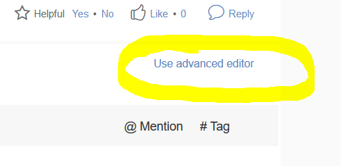

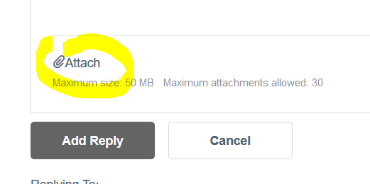

Sorry to say I am new to this forum and  I am not getting how to post the hex and bin files here.
10,019 Views
mjbcswitzerland
Specialist V
Select "Use advanced editor"
and then there will be an attachment method.
Mark
