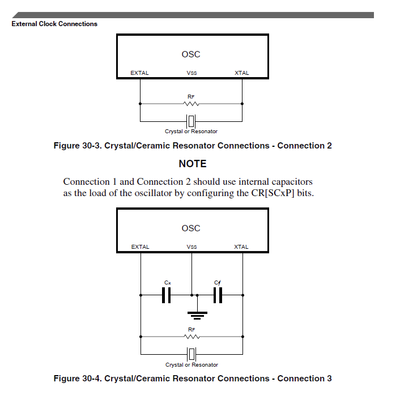

Can you provide your schematic for external clock part?
Please refer to the OSC section here:
Additionally, I recommend that you perform basic unit testing, specifically: setting aside QSPI, just create a simple clock test program to check whether the current hardware OSCERCLK outputs normally with HGO=1. First, isolate all code and functions related to QSPI and test the clock separately.

As requested, I attached the external clock design.

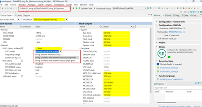

I tried to load a new project and set the gain mode by using the MCUXpresso Config Tool, but I was not able to change it in clock section. The default mode is the "Low Power" one and it is not editable. I try to deepen the problem, but every suggestion is really appreciate from your side.

I have sent your schematic to the internal team for further support.
The SDK for K81 is too outdated. You can try the SDK demo for K82. I tested it, and it allows successful modification of the OSC mode using MCUXPresso Config Tools.
After that, refer to the code changes made during the "update code" button and apply those updates to your K81 project.
