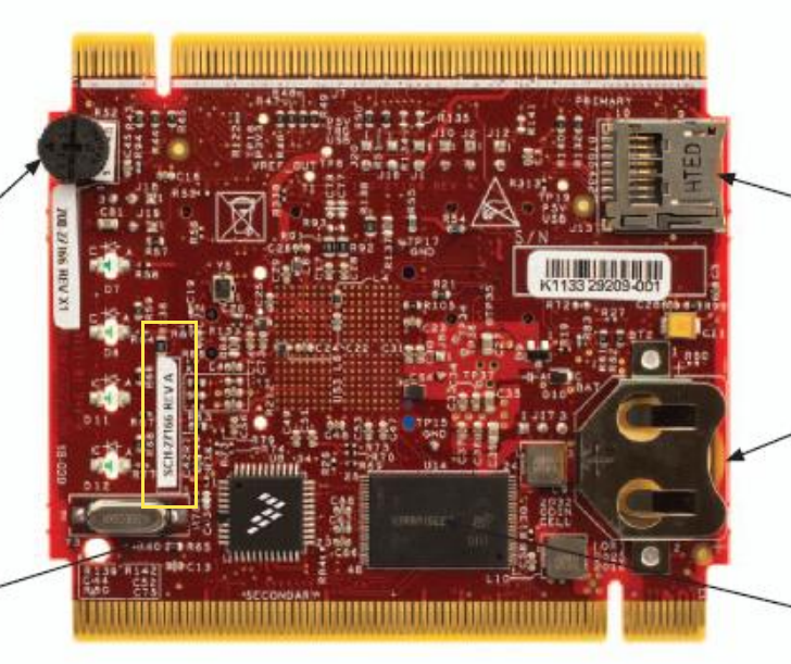

I am 2 TWR-K70F120M board
In one sdcard is working ,and other its not working

In the working tower board ,its showing
Bus Width: 4-bit

Could you please provide the TWR-K70F120M board hardware version info?
If both boards with the same hardware version?

Both have same version sch-27166 Rev B1

Sorry for the later reply.
I checked the system record, there without related info before.
Please check here to warranty replacement that issued TWR-K70F120M board. Thanks.
