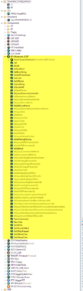

Is there any way I could communicate HC06 with FRDM K64f using KDS? Would appreciate any help. I haven't found any tutorial on NXP regarding this. I know how to use it using mbed but I need to do it using KDS.

there is an example for FRDM-K64F using the Bluetooth connector on that board with HC06:
mcuoneclipse/Examples/KDS/FRDM-K64F120M/FRDM-K64F_Demo at master · ErichStyger/mcuoneclipse · GitHub
with a full driver for the Bluetooth module:
The extra components are available on SourceForge, see McuOnEclipse Releases on SourceForge | MCU on Eclipse
