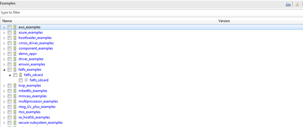

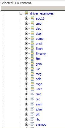

Kevin, where did you find SDHC example in NXP SDK ?
I do not see any example of sdcard neither sdhc in the latest SDK v2.4  - was it removed?
See my list of driver_examples which came with FRDM-K64F SDK v2.4.0 . Notice - I've built this SDK with SDHC and fatFS components chosen.
What happened? Was it removed? Please advise
5,805 Views
danielchen
Hi  Vladimir
sdcard_fs was removed to this folder
FRDM-K64F_2.4_all_20180605\boards\frdmk64f\fatfs_examples\fatfs_sdcard

Thanks for reply, Daniel . In my current SDK folder boards\frdmk64f\  there is no "fatfs_examples"  . When configuring SDK package for FRDM-K64F board , I included SDHC and fatFS drivers.  Did you include something else or was your SDK not latest ?
5,805 Views
danielchen
In the latest SDK 2.5 for Frdm-k64f board, you can see fatfs_examples.
