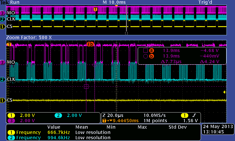

We made a custom board based on the MK20DX256VLK100 kinetis microcontroller. Now I'm trying to use the SPI0 port to control some other device, something so simple that MQXLite functionalities are enough for my application. End of the easy and good part of the story.
The device I need to control requires CS to be kept asserted (LOW) for the entire transaction time (as usually happeds) so I tried the following solutions:
1) Configuring the chipselect list with one entry and properly indicating the CS output pin.
It seems to work if this conditions {1.a and {1.b-1 or 1.b-2} } apply:
1.a) Transactions in ONLY ONE DIRECTION (only read or only write)
1.b-1) Transactions with ONLY ONE CHAR, or
1.b-2) Transactions with VERY LONG DELAY BETWEEN CHARS.

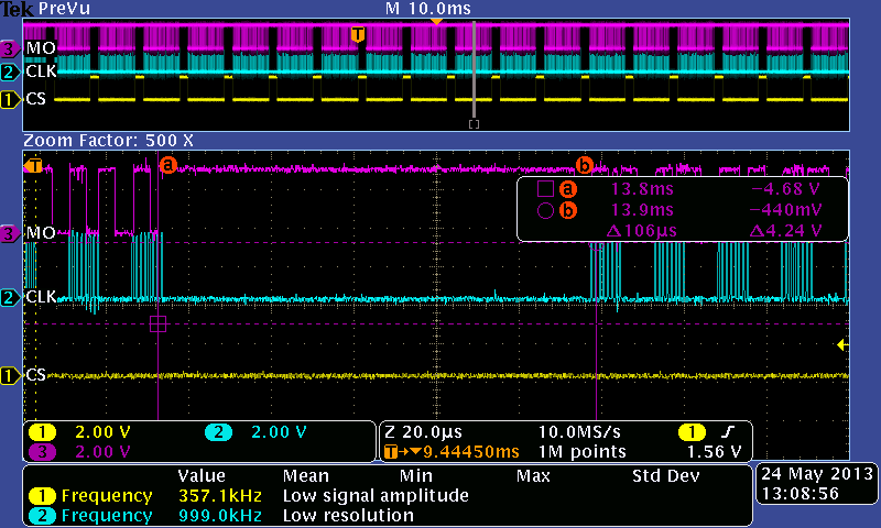

As one interrupt is required for sending EACH and EVERY char to Tx FIFO, under some circumtances the delay introduced between one char and the next is greater that the Delay Between Chars PE Parameter so CS is automatically deasserted (Driven HIGH) by the silicon IP. And that is totally wrong!
When the transaction involved TX {n} chars and RX {m} chars... it was impossible to keep CS asserted, always was driven HIGH before being able to even start reading.
Here is a screen capture from the DSO: CS is Ch1, CK is Ch4 and MOSI is Ch3. This corresponds to one TX transaction, three bytes long.

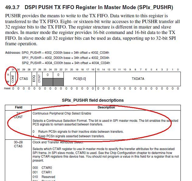

From the auto-generated code and some samples I've seen, it seems that the silicon IP does not automatically generate CLK pulses for reading so it's needed to call the _SendBlock() function after the call to _ReceiveBlock().
Am I right on that? Is there any other method for making write+read transactions without calling _SendBlock() twice?

Using the SPI_PUSHR_EOQ_MASK method could also do part of the job. The PE driver could be improved simplifying last byte stream out completion detection (and other tasks) by taking advantage of this (and others) silicon IP functionalities.

There is a control bit to keep CS asserted between transfers, the details can be referred from below:
you may configure it in PE, please refer to the following for details.

Hi Kan,
I think I made one mistake when writing use case 1.b-2), it should say "1.b-2) Transactions with VERY LONG SHORT DELAY BETWEEN CHARS." (lowest interrupt latency as possible)
I was aware of the "Continuous Peripheral Chipselect Enable" configuration parameter. The DSO capture in fact corresponds to one test run with this parameter enabled. The thing to be noticed in the screen capture is timing, in PE I configured the parameter "CLK to CS" to be 2.56us (+-5%), and CS just goes high (deasserted) after this time has elapsed from the last CLK edge of previous char.
The DSO capture was for depicting the situation in a deterministic way, real problem was hard to debug as it was related to interrupt latency, one higher priority interrupt was taking too long (as long as 4us can be too long, of course) to return and that caused the issue.
At the end, and just for not being wasting too much of my time on that at this moment, I simply manage CS manually and make one short delay (num_bits*bit_duration) after detecting that the last TX char has been sent to TX FIFO.
Current driver implementation doesnot properly support (from my modest knowledge and point of view) the TX and RX FIFO's.
There is one workaround on this for write+read transactions, provided that you can affoard to have 'long' enough delays between transactions, and is to reserve one buffer of (Tx count + Rx count) bytes with the first Tx_count bytes corresponding to data to emit and leaving the rest for reception. After calling **_SPI_ReceiveBlock( ?,Rx_count ) and **_SPI_SendBlock( ?, Tx_count ) it's just a matter of adjunting (moving) the buffer contents. Not a good enough solution (bad design/practice in fact) but works.
