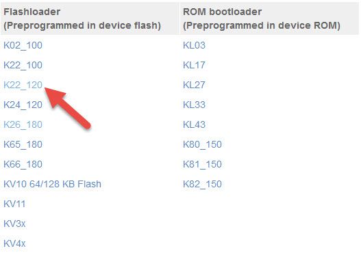

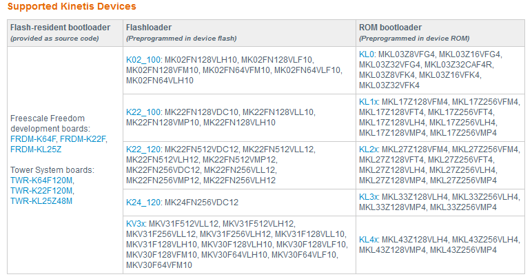

I read through the forum, found a list of MCUs pre-programmed with flashloader which doen't  have MK22FN1M0AVLH12 listed. Doe Flashloader support this MCU now? What is in this IC's flash when it goes out from factory? If it's empty, can I order pre-programmed ICs with my bootloader ported from bootloader 1.2?

Hi Jenny,
The MK22FN1M0AVLH12 contains the Flashloader in the Flash from the factory as the Fig1 shows.

But From 3/2015's post, the K22_120 family doesn't include 1Mb version.  And from test, looks like the IC is empty. Please verify the flashloader support the particular IC MK22FN1M0AVLH12.
