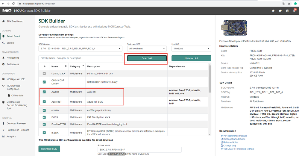

  In fact, a lot of new Kinetis chip already add the IOT code, eg, AWS IOT with MQTT.

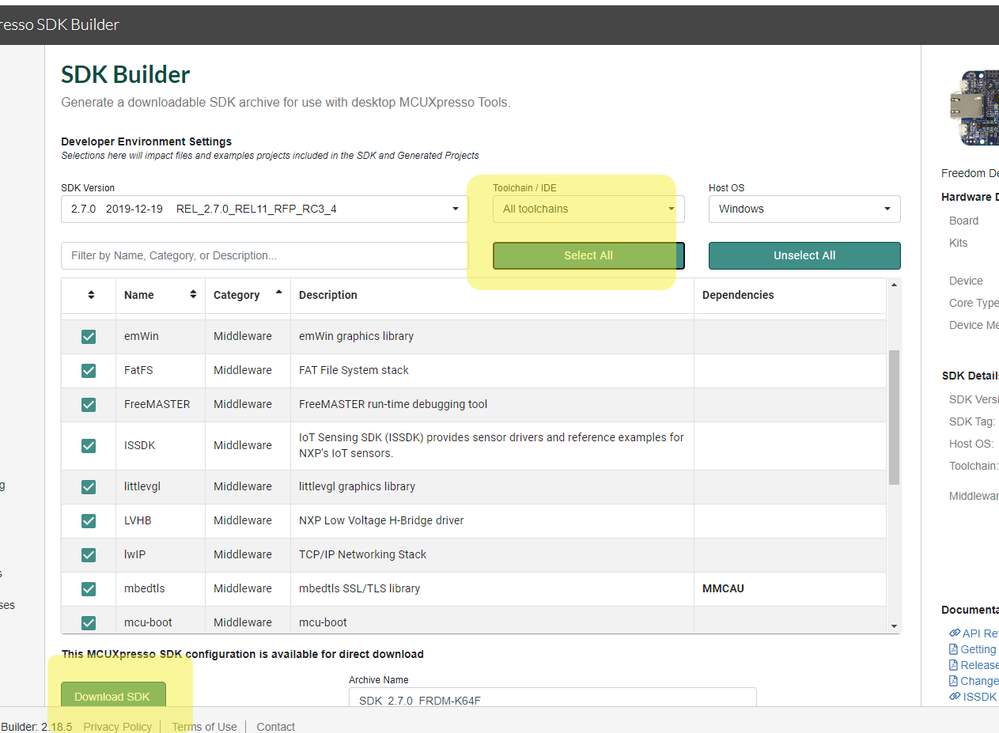

  K70 doesn't have the detail code, but I think you can refer to the FRDM-k64 board,  you can download the K64 SDK code from this link:
https://mcuxpresso.nxp.com/en/builder
The Middleware select all:   pastedImage_1.png
especially, AWS IOT, freertos, LWIP.
  Then generate the code and download it.

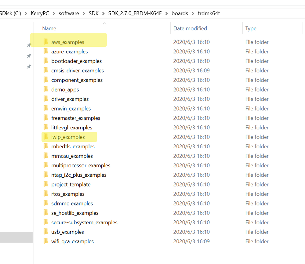

  You can find the AWS IOT in the folder:
  SDK_2.7.0_FRDM-K64F\boards\frdmk64f\aws_examples
  The AWS code already contains the authentication.
   The direct MQTT with LWIP can be found in the folder:
SDK_2.7.0_FRDM-K64F\boards\frdmk64f\lwip_examples\lwip_mqtt
Please refer to it at first.

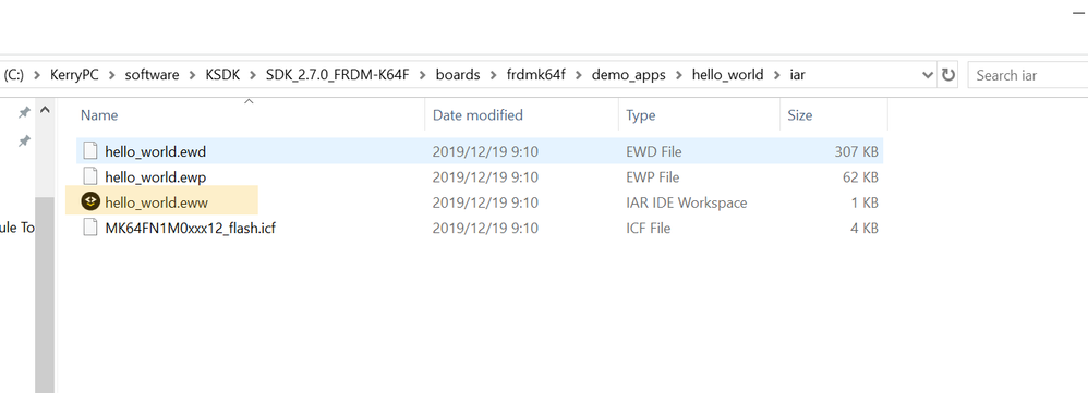

kerryzhou
Hi Gary Lynch,
    I check it on my side, the IAR project exist:
So, if you still have issues, I suggest the toolchain/IDE select all, then download the SDK again.
If you still have issues about it, please kindly let me know.
Kerry

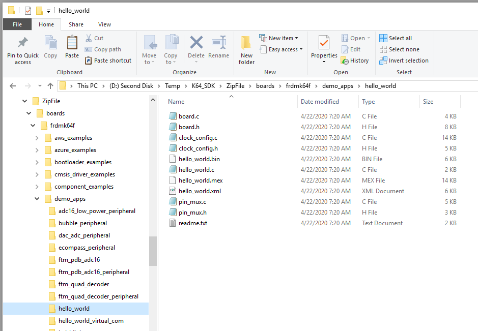

garylynch
Thanks again, Kerry.
I downloaded and unzipped it again.  When I look in the location you show:
The IAR directory doesn't even exist. What am I missing here?

kerryzhou
Hi Gary Lynch,
   That's strange, your SDK name is also not correct,it should be SDK_2.7.0_FRDM-K64 do you download it from the link which I recommend you?
https://mcuxpresso.nxp.com/en/select
Please try it again.
If you still have questions about it, please kindly let me know.

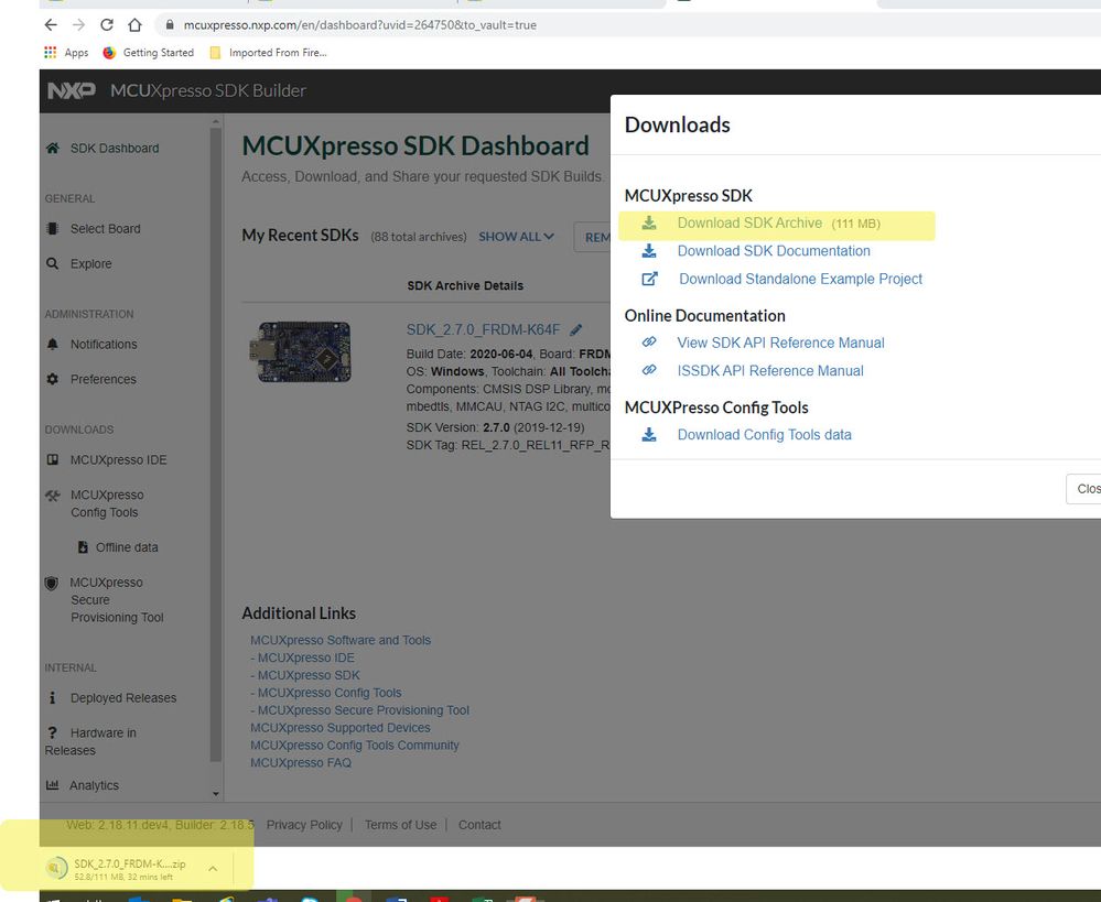

garylynch
Ok, by clicking very carefully I retrieved a zip file with 11 MB, as shown in your graphic. When unzipped, I can load the hello_world.eww file into IAR.
Then I try and build it.  There are several ways to do this in IAR, I used:
  Project >> Rebuild All
This spits out 22 errors. I will attach a copy of the build log in case that will highlight the details.

kerryzhou
Hi Gary Lynch,

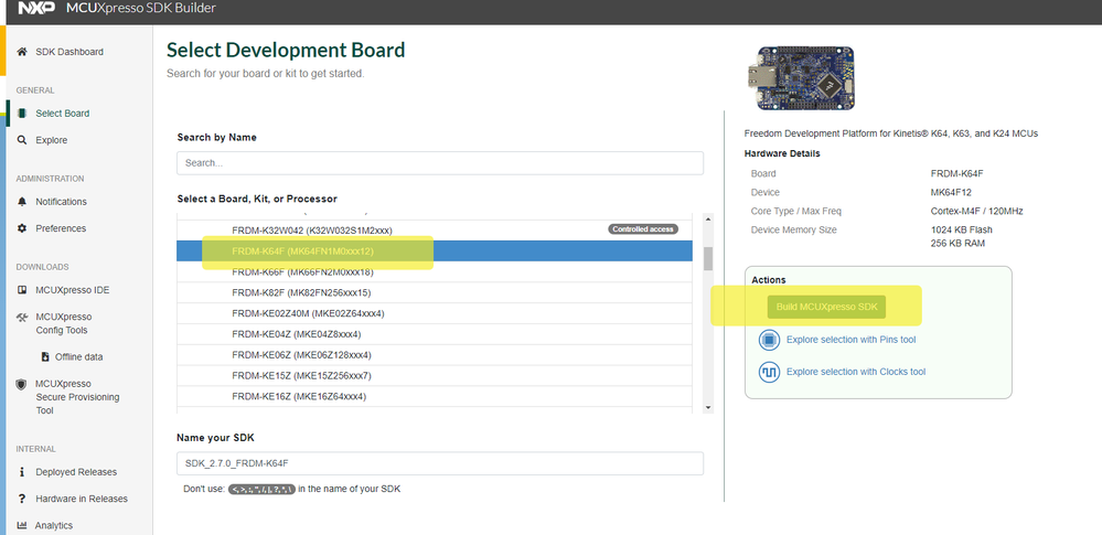

  That's strange, please give me the same picture like me on your side.
  Welcome | MCUXpresso SDK Builder
  Press the select develpment board button, the middleware select.
  What's the PC system you are using? windows 10?
  What's the IAR version you are using?
Kerry

garylynch
Ok, Kerry,
Here's how I followed your instructions:
 1. Follow link to https://mcuxpresso.nxp.com/en/welcome
 2. Click on [Select Development Board].
    This lands me on a page full of empty text boxes with headings:
    - Search by Name
    - Select a Board, Kit, or Processor
      · Boards
      · Kits
      · Processors
    - Name your SDK
 3. I select:
      Boards
        Kinetis
          FRDM-K64F (MK64FN10M0xxx12)    {I took this from the graphic in your post of Jun 3, 2020 1:24 AM}
 4. The page fills in "Name your SDK" with "SDK_2.7.0_FRDM-K64F"
 5. I click on [Build MCUXpresso SDK]
 6. This begets a page with "SDK Version" = "2.7.0 2019-12-19."
 7. In the "Toolchain / IDE" textbox I leave "All toolchains".
    In the "Host OS" textbox I leave "Windows"
 8. I click on [Select All]. All the checkboxes to the left get filled with checkmarks.
 9. I click on [Download SDK]. After some churning I am asked to accept a software T&C contract, to which I agree.
10. A dialog box pops up with SDK_2.7.0_FRDM-K64F (1).zip, which I open with 7-zip.
11. I unzip the package to K64_SDK2, being careful not to send anything through my wifi connection.

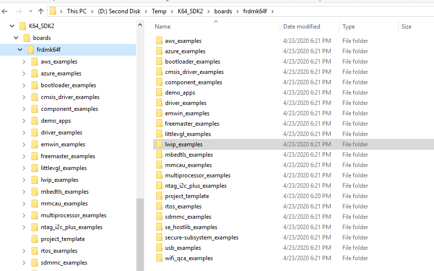

12. I open Windows explorer to the folder you requested:
      I don't see much difference, except my files are almost 6 weeks older than yours.
Yes, I am running under Windows 10.
My Embedded Workbench is version 7.80.4.12495.
Hope this gets us closer to the truth.

kerryzhou
Hi Gary Lynch
  I find your picture already contains the AWS, and the LWIP project, do you open it? Can you find the IAR project?
  Your generated code already contains the related IOT project, MQTT project.
  You also can refer to the doc, there has a get start document.
  If you still have questions about it, please kindly let me know!

garylynch
Hello Kerry,
The link you provided leads to a page that doesn't resemble the graphic in your original post.  It was necessary for me to choose parameters, use the search engine, come up with my own data before I got an SDK.  I will try again and pay attention to the exact spelling.
