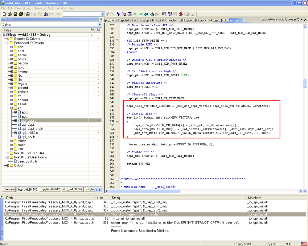

Actually, MQX automatically installs the spi isr when it initializes this module, please kindly refer to the following for details.
You may set a breakpoint there to see if the ISR copy done correctly by step trace for your case. if you want to use a custom ISR instead, you may install it after that with the api _int_install_isr().

I am using a baremetal ISR here (I modified the vectors.c and hard-coded my ISR there)
The solution here was adding this code at the start of the application:
#ifdef BOOTLOADER_ENABLE
// Copy Application Stored Interrupt Vector table for SPI2 to SRAM
pdst=(uint_32*)0x1FFF80B0;     // SPI2 interrupt vector in SRAM.
psrc=(uint_32*)0x0000C0B0;     // SPI2 interrupt vector in Flash.
for (i=0;i<0x1;i++,pdst++,psrc++)
    *pdst=*psrc;
#endif
BUT this was using MQX 3.8. Now I'm using MQX 4.0 and I'm having the same problems.
