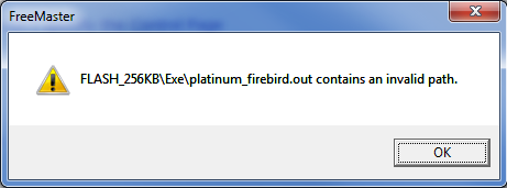

Thank you for sharing the Bluetooth project. Adding some instructions to work properly.
The following error appears on FreeMaster when "freemasterDemo.pmp" project is opened.

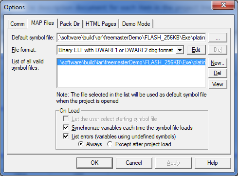

If you are not going to modify the KL46 memory map, you can dismiss this message. If you want to modify the shared code you need to add the correct path to the project ".out" file as follow: software\build\iar\freemasterDemo\FLASH_256KB\Exe\platinum_firebird.out
Menu: Project/ Options / MAP Files
