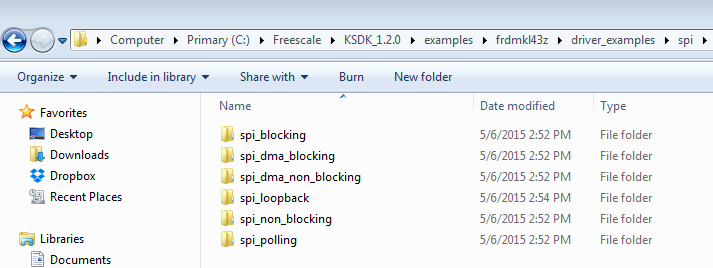

Hi Piotr,
Unfortunately we don't have a library to work with the SSD1306 LCD, but you can find several SPI driver examples in Kinetis SDK that can help you create your LCD driver:
Kinetis SDK can be downloaded from the link below, choose the Kinetis SDK 1.2 Mainline which is the newest version and supports the KL43Z MCUs:
Software Development Kit for Kinetis MCUs|Freescale

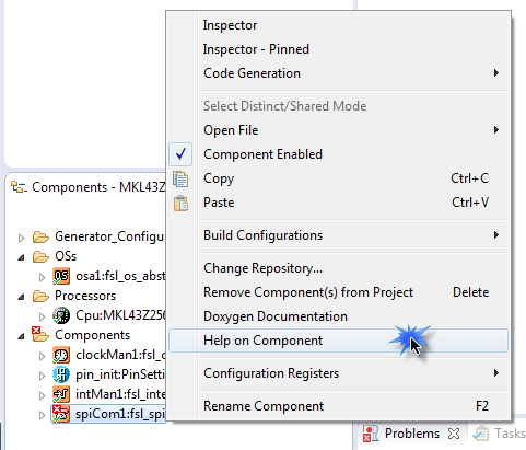

You can also use Processor Expert with Kinetis SDK, information about the fsl_spi component properties, methods and events can be found on the help of the component:
Hope it helps!
