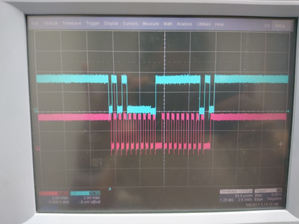

I am using the SKEAZ16NLC part and trying to interface it with an external EEPROM 24LC32A which communicates through I2C. I am using KDS and PE to make the write/read to work.There is a driver for EEPROm in Erich Styger's blog.
Driver for Microchip 24xx Serial EEPROM | MCU on Eclipse
I have a screengrab of the scope lines on SDA and SCL on the chip.
I see that the ACK bit is not set as a result of which write/read is not happening.
Scope image is attached. I am wondering what the issue is. I would like to know if there are any steps to debug this issues.
I stepped through the code and checked for PRIMASK register setting to check if interrupts are enabled and they are. Any help is much appreciated.

I don't understand the issue.  The scope DOES show ACK on each of the two bytes (write command, address byte 0xFF) showing as the zero in the 9th clock of each, made 'more visible' by being a slightly lower 'zero state' voltage, being driven from a different IC. In what way is the overall driver 'not working'?

RadekS
Hi Earl,
You are fully right. I didn’t count all SCL edges and I missed that “detail”. I expected that “I see that the ACK bit is not set” is true.
So, memory behavior is correct and some potentieal issue may be probably in the code/settings.
Saipriya,
since 32Kbit presents 4096 bytes, the address for write commend must be transmitted in two bytes (0xX000~0xXFFF where X are “don’t care” bits).
The waveform at Scope image looks rather like acknowledge pooling action after a write command. This pooling may be used for checking whether data was already written or not (memory do not send acknowledge during a write operation). See ACKNOWLEDGE POLLING chapter in memory datasheet.
So, this waveform looks like the last execution of res = GI2C1_WriteBlock(block, 1, GI2C1_SEND_STOP); command.
So, could you please specify reason why you think that write/read is not happening?
I hope it helps you.
Radek

RadekS
Hi Saipriya,
Are you sure that A0, A1 and A2 pins at your EEPROM are configured as low?
Are you sure that WP pins are connected to VSS for enabling write commands? However, this should not have any direct  influence on acknowledging.
The highest four bits from Address High Byte should be “don’t care” bits, but I would try to configure them as 0 - just for sure.
Radek
6,853 Views
saipriyasubrama
Yes Radek. I made sure A0,A1,A2,WP and Vss are at 0V and they are.
I have attached my KDS project in case you might catch any bug that I might have missed. Thanks.
