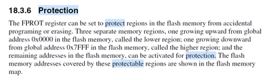

nxf56274
May be you can refer the FPROT. It can protect the flash from programming and erasing.

if we enable the FPROT , mass erase is still working right? (JTAG)
5,381 Views
nxf56274
Yes. You can also try to use the backdoor key to set the flash as security to avoid being erased.
