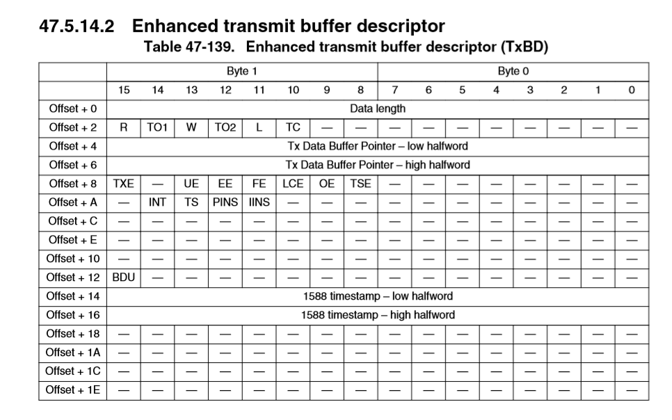

Hello everyone,
I want to see if you guys would help me figure out a little more on how to accomplish this. I'm use a Kinetis K60 Tower board and I want to set up communication between them using ethernet MAC only. Is this possible without setting up a higher software layer for TCP/IP? Basically for this project I want to be able to receive data from UART or a file from an SD card, user ethernet to transfer the data to another K60 and send that data out via UART or store it on an SD card.
Right now I'm having trouble finding out how to put together the frames correctly. I used Processor Expert to generate code for the ethernet component to learn more on how it works. I mostly understand it but one thing I simply can't find is how to set the destination address of a frame. The RM talks about this being part of the frame and that it's needed, but I can't seem to find a register that writes this part nor does it seem to be part of the buffer ring descriptor.
Also, is there any way I can see the actual code for some of the PE modules? I found that this is one for reading a file as binary and it breaks it down into a byte array, which I think would actually help me in this application.
Thanks for your help in advance!

You have shown the TxBD in enhanced mode (to use this one the enhanced mode needs to be enabled, but its basic operation is similar to the standard buffer descriptor too).
- TxBufferPointer points to the frame that your SW needs to prepare - this must be 8 byte aligned. (This memory is the buffer descriptors actual frame buffer memory)
- The destination MAC address is written to the first 6 byte of that buffer (not the Buffer descriptor itself).
- After the MAC address (in the frame buffer memory) you fill it with the other values in the Ethernet II frame (including your own MAC address too) and then with your own protocol payload (or IP/TCP etc. with payload)
- You must ensure that there are at least two Tx buffer descriptors chained otherwise the frame will be sent more than once (see errata).
- You must also provide the buffer descriptor memory, which must be 16 byte aligned.

For your Ethernet destination question it is best to read about the Ethernet II frame: https://en.wikipedia.org/wiki/Ethernet_frame#Ethernet_II whereby it means simply that the first 6 bytes that the software prepares for the first buffer descriptor is the destination address.

But I'm still compelled to code all these functions myself or at least understand them thoroughly. I know that the first six bytes are the destination address and the rest of the padding is created by the MAC, but my question still isn't answered. You pointed me to the information and said the software does it. If I'm the one writing that software, how would I do it? I want to know how it works completely tool free. So far I've understood most of how to prepare and send a frame, it's just this simple process of defining a destination address. That's the information I'm most after.
You mentioned that the software writes this in the first buffer descriptor, but I don't see a field for it. Unless there's another descriptor I need for that?

Actually, part of this project is to develop functions from scratch more or less. At least, we need access to the lowest level of code in order to make changes if needed because the project itself is not a normal case. We may need to implement error correction other than what the MAC provides. (The transmission isn't going to be over wire or wifi, but another medium we're researching) So the time for development is ok. I understand the concern to waste time redoing work that's already been done and available.
These points are exactly what I was looking for. I think I'll be able to move forward with it. Thank you for taking the time to answer my questions.
