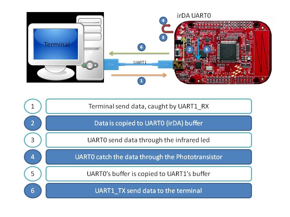

Philosophy of the Example
In the attachments of this post you can find the example which shows the use of these functions in a basic application; the project was compiled in CodeWarrior 10.6 and the philosophy is:
I hope that the information presented on this document could be useful for you. Thank you!
