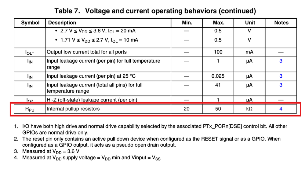

You have to check the data sheet of the KL03Z how strong the pull-ups are. Typically they will be in the 100kOhm range, so while it 'can work', I never would use that in a product as they are too weak. It is simply not reliable. Depending on the devices on your bus and the lines, typically you need something in the 4.7-10k range. See as well http://www.ti.com/lit/an/slva689/slva689.pdf

You're right. I'd need external pull-up resistors in the 4k7-10k range, as usual...

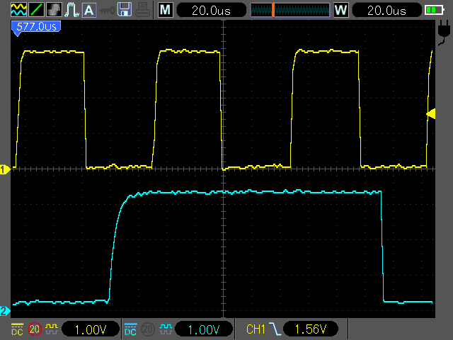

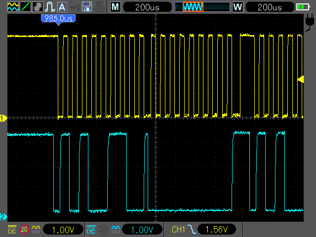

However, I have planned to investigate a little more to see how far I can go. The fact is that I'm finally able to use the I2C bus successfully and reliably using the internal pull-up. Of course, under certain considerations I will explain below.
  1. Internal pull-up strength of KL03Z. Luckily, for this device family, they fall in the range of 20k-50kSelection_024.png
  2. Bus capacitance and rise time: In my application, it is a single master-slave I2C bus without branches and with a length of 2mm (the microprocessor and the slave are placed together). Therefore I can have a very small capacity that I can estimate in about 4pF+ 8pF x 2 of devices pin capacitance (Cb total 20pF). For the maximum rise time of SDA/SCL lines, the I2C spec for the standard mode (100KHz) is tr_max = 1000ns. Then the max pull-up resistance is Rpu_max = tr_max / (Cb x 0.8473) = 59k
  3. Finally, I don't need to go at 100KHz. For my application 10kHz is enough. Here's some results of the bus lines.pic_420_1.gifpic_420_2.gif
Thanks for the given hints!
