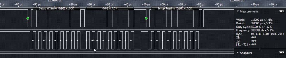

kaslewis
Hello Ma,
I am using a PmodTMP2 from Digilent that has a Analog Devices ADT7420 on board. I have added two 4.7k pull up resistors one to the SCL line and the other to the SDA line. I can see the KEA-64 sending data but when it comes to recive data from the ADT7420 the KEA-64 does not provide a clock source. I have tried a dummy read and a dummy write but neither seem to provide a clock source.
Kas

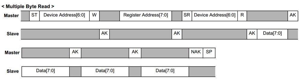

Hui_Ma
Hi Kas,
Analog Devices ADT7420 with the same I2C process with MMA8451 chip.
ADT7420 register read process:
MMA8451 register read process:
Customer could refer K60 100MHz i2c_demo from attached file, which shows how to read data from MMA8451 chip.
I just abstract the read register processing for your reference:

kaslewis
Hello Ma,
Can you please look over the code I have posted as it looks very similar, I just do not use macros I call everything explicitly. I have included output from the logic analyzer and as you can see the only thing missing is the clock needed for the device to replay to the KEA-64. I have looked at ALL the code you have provided but NOTHING seems to be working, therefore postinhg more code will NOT help, rather please look at what I have done and let me know what is wrong.
2014-11-30 15_10_36-Saleae Logic 1.1.15 - [Connected] - [12 MHz, 1000 B Samples].jpg
6,381 Views
Hui_Ma
Hi Kas,
I checked your code with below error:
in main() function, when you want to change I2C module mode from write to read, the below code is incorrect:
I2C0_C1 &= !I2C_C1_TX_MASK;
The correct code is :
I2C0_C1 &= ~I2C_C1_TX_MASK;
And when you want to get the ADT7420 ID value, it need to read I2C0_D register twice, please refer below code:
    i2c_give_nack(I2C0_B);      //your code is I2C0_C1 |= I2C_C1_TXAK_MASK;
    result = i2c_read_byte(I2C0_B);   //your code is  replay = I2C0_D;
    i2c_wait(I2C0_B);    //your code is    while ((I2C0_S & I2C_S_IICIF_MASK) == 0){  //Wait for data to transmit  }
    i2c_stop(I2C0_B);    //your code need to add as   I2C0_C1  &= ~I2C_C1_MST_MASK;  I2C0_C1  &= ~I2C_C1_TX_MASK;
    result = i2c_read_byte(I2C0_B);  //your code need to add as   replay = I2C0_D;
