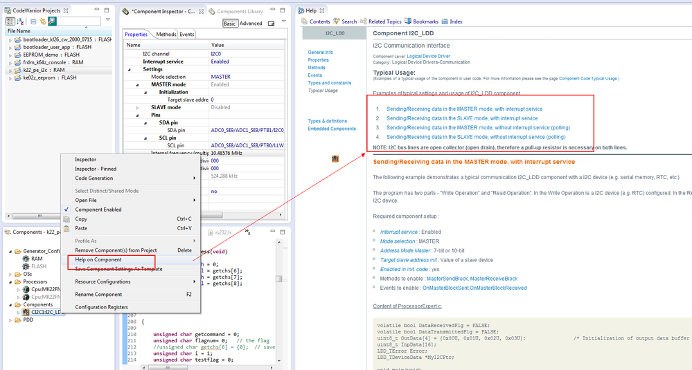

Hello Negar,
(1) I see you use CodeWarrior , so you can refer to the demo code here :
after you create a PE project , add the I2C component , then you will find this .
(2) Or you can install the KSDK 1.2  (here :New KSDK 1.2. is available!  ),  then under the directory , you can find I2C demo :
....... Freescale\KSDK_1.2.0\examples\frdmk22f\driver_examples\i2c
Hope it helps !
