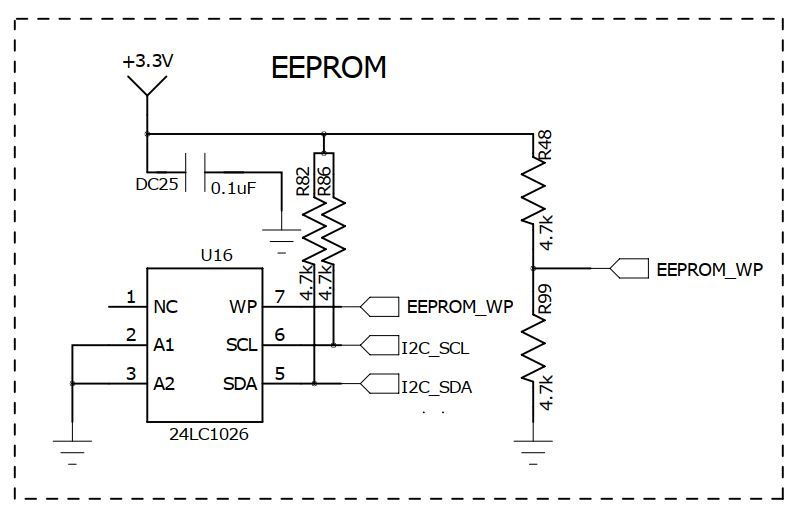

I am using the MK66FN2M0VLQ18 to communicate with external EEPROM(24LC1026) with I2C interface, While interfacing with the EEPROM I a getting the NACK error what may be the problem. I am using the SDK of MK66.

durgasivakrishn
Thanks for both of you it is working fine I am able to write and read from EEPROM, But I got 2 more questions
1.) In MK66FN20VLQ18 if we configure the pin as I2C line, By default open-drain configuration is not enabled?
2.) After making the I2C pin as open-drain it is working fine(able to write and read from EEPROM) in the flash but when I run in the debug SDA pin state changed to LOW and I am getting the BUSY error what may be the problem, I tried placing the delay after pin initialization and I2C initialization but it didn't work.

durgasivakrishn
Dear Myke,
I am considering it is working fine because I am able to see pulses on the SDA pin, But if I do debug pulses are not coming and SDA is LOW.
Debug means I am going to debug mode using Ulink2 and making it full run in this scenario it is not working and the state of the SDA pin is going to LOW. Even I do the step over the same problem is arising.

6,373 Views
durgasivakrishn
Dear Myke,
Thanks for your response, Here I am briefing the code
/* Port B Clock Gate Control: Clock enabled */
CLOCK_EnableClock(kCLOCK_PortB);
if use the below it is not working
|---------------------------------------- NOT WORKING ----------------------------------------|
/* PORTB2 (pin 83) is configured as I2C0_SCL */
PORT_SetPinMux(PORTB, 2U, kPORT_MuxAlt2);
/* PORTB3 (pin 84) is configured as I2C0_SDA */
PORT_SetPinMux(PORTB, 3U, kPORT_MuxAlt2);
|---------------------------------------- WORKING ----------------------------------------|
if use the below it is working
Pin_Config.openDrainEnable = kPORT_OpenDrainEnable;
Pin_Config.driveStrength = kPORT_LowDriveStrength;
Pin_Config.lockRegister = kPORT_UnlockRegister;
Pin_Config.mux = kPORT_MuxAlt2;
Pin_Config.pullSelect = kPORT_PullDisable;
Pin_Config.slewRate = kPORT_FastSlewRate;
PORT_SetPinConfig(PORTB,2U,&Pin_Config);
PORT_SetPinConfig(PORTB,3U,&Pin_Config);

durgasivakrishn
Dear Myke,
Thanks for your response, Here I am attaching the schematic and code. R99 is mounted and R48 is not mounted and EEPROM_WP pin is gpio making it low,
i2c_master_transfer_t Master_TX;
i2c_master_handle_t Master_TX_Handler;
uint8_t EEPROM_Tx[10]={0},EEPROM_Rx[10]={0},Return_Val=0;
#define I2C_MASTER_SLAVE_ADDR_7BIT 0xA0U
void EEPROM_Write(void)
Master_TX.slaveAddress = I2C_MASTER_SLAVE_ADDR_7BIT;
Master_TX.direction = kI2C_Write;
Master_TX.subaddress = 0;
Master_TX.subaddressSize = 2;
Master_TX.data = EEPROM_Tx;
Master_TX.dataSize = 2;
Master_TX.flags = kI2C_TransferDefaultFlag;
EEPROM_Tx[0] = 0x10;
EEPROM_Tx[1] = 0x20;
while(1)
I2C_MasterTransferBlocking(I2C_EEPROM_PERIPHERAL, &Master_TX);
Delay(0xFFFF);
with regards,
Sivakrishna

myke_predko
Senior Contributor III
Hi Sivakrishna,
I think Da Li and I are inagreement - try again with:
#define I2C_MASTER_SLAVE_ADDR_7BIT 0x50U
Let us know how you make out.
myke
6,373 Views
nxf56274
Try to modify I2C_MASTER_SLAVE_ADDR_7BIT  to 0x50U
TIC
6,373 Views
myke_predko
Any chance at getting more information?  Could you share you code and wiring?
Regardless, the first place to look for an I2C NACK error (after checking your wiring and power) is the address that is being used to address the device.
I just did a quick look at the datasheet for the 24LC1026 and saw that the address sent to the peripheral device is 8 bits and includes four bits for the address, two chip address (set by the pins on the chip), a block bit and a read/write bit.  It's a little hard to visualize, but the address you give the Kinetis is shifted up by one and the read/write bit added to the hardware - so to get the correct address sent out to the chip, shift the device address down by one (or divide by 2) to put out the correct address on the bus.
If you have A1, A2 tied low and you wanted to write to block 0 of the chip, you would be sending an address of 0b10100000 (0xA0) BUT because of the read/write bit is handled in hardware and added to the address, you have to shift this down by one bit (to 0b01010000) and set address to 0x50 for the I2C hardare.
Take a look at what you have and let us know what you find.
