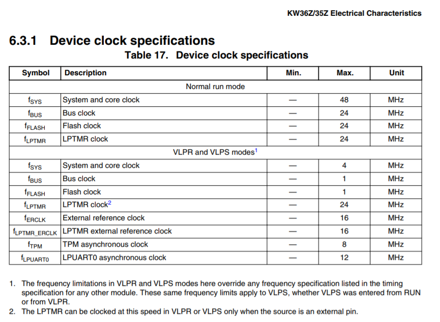

I want to know about maximum timer value for KW36z controller. How to get that value by calculation.

What do you mean by timer value? Also, which timer are you referring to?
