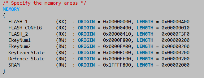

 I use KEAZ64 , another question,I defined a new sectors for my application, like this below, is this right?
,do i need to modfied flash.ld file and startup_SKEAZ1284.S file?

1. data = (*(unsigned char*)0xf801) :   Yes, it's ok. But take care, something like  (*(unsigned int*)0xf801) will cause hardfault. It's not an alignment reading.
2. You can download it at https://www.nxp.com/webapp/sps/download/preDownload.jsp.
3. Of course you must modified flash.ld.
