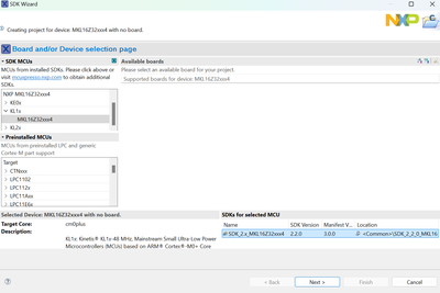

I tried your suggestions, selected MKL16Z32xxx4 SDK, and created the led_Output project.
But in the MCU it is still MKL26Z128xxx4. will it work on MKL16Z32 MCU?

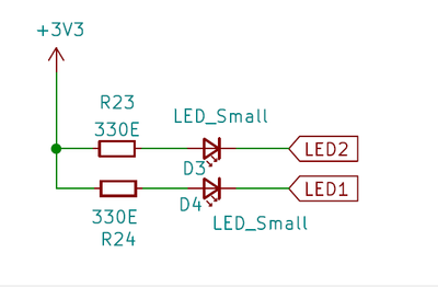

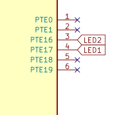

ss114
I have a custom board which is prepared using MKL16Z32VFM4 and I have the schematics also.
ss114_0-1731041987295.pngss114_0-1731041987295.pngss114_1-1731041991723.pngss114_1-1731041991723.png
Do I need to configure an external crystal oscillator?
What are the steps to create a project that doesn't have a dev board?
I believe some configurations I am missing.
How can we create the project for a custom board?

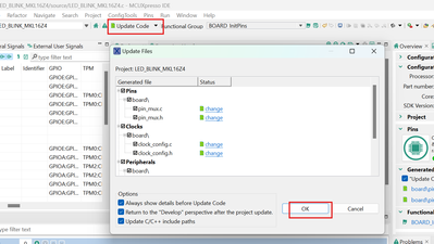

4,366 Views
Celeste_Liu
Hello @ss114 ,

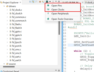

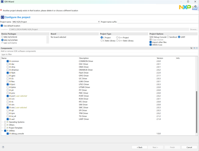

I think you may have missed the pins and clocks initialization for your custom boards. Regarding how to create a project for a custom board, as a suggestion, I think is better to create a project for the KL16Z and base your code in the examples from the KL26Z, with this you won't need to modify the startup code or the linker file. You can refer to the following steps:
1. Create a new C/C++ project.
2. Select the MKL16Z32xxx4 SDK, then select the required components and click Finish.
3. Use the Project Explorer menu bar to launch Config Tools, open Pins to multiplex pin signals and open Clocks to change the clock configuration.
4. Click "Update Code" to save the config settings (.mex) and generate the pin and clock source files.
5. Modify the main function and related functions, compile and debug.
Sorry, we can't help you debug because we don't have a custom board. But don't worry. If there are any problems, feel free to contact me at any time. In addition, I provide some links. I think they will be helpful to you.

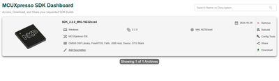

Thank you for contacting NXP Tech Support. Regarding the SDK for MKL16Z32VLH4, the SDK shown in your attached figure is exactly what you need.
As for how to download the SDK to MCUXpresso, you can refer to the following picture or Import SDK .
For more information on how to operate using MCUXpresso, you can refer to “3.2.1 Running a demo using MCUXpresso IDE” on this webpage .
