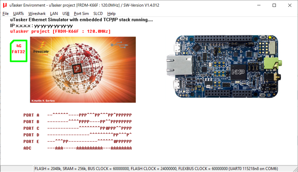

If you have a 50MHz crystal or oscillator you can use it for USB device or host with settings:
PLL input divide 5 (to give 10MHz input), 24x multiply to give 240MHz PLL output (120MHz core), select MCGPLLCLK as source to USB and SIM_CLKDIV2 to 0x00000009 (divide 5 with fraction set).
In the uTasker project this is highly automated so I just chose
K66,
not USB_HS_INTERFACE
#define CRYSTAL_FREQUENCY   50000000
#define CLOCK_DIV           5
#define CLOCK_MUL        24
and then its simulator conformed all operation in device and host modes and I could read the values that were set.

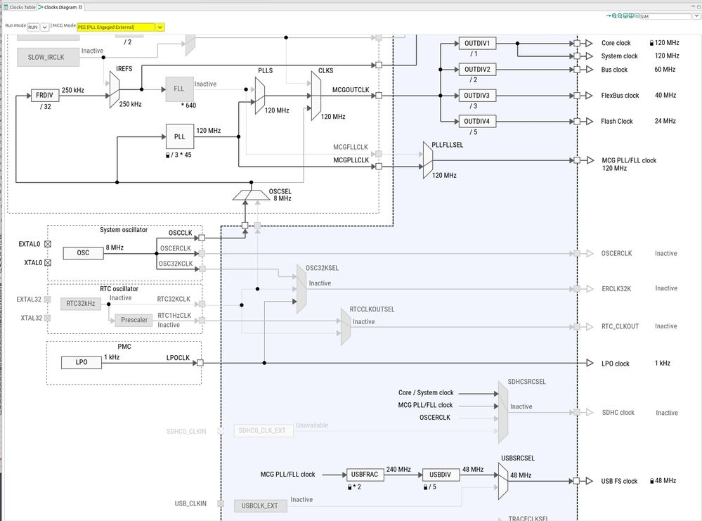

AFAIK, you must have a 48MHz clock going into the USB module, which means that you need a base clock that can be divided/multiplied to 48MHz within the confines of the circuitry within the Kinetis.  I don't think this is possible with a 50MHz clock.  This should be the first issue that you need to address: get a 48MHz clock out at "USB FS clock" and see where you need to go from there.
There is no single point of reference explaining Kinetis clocking and, while the clock tool in MCUXpresso is helpful, there's nothing that allows you to enter in your requirements and spit out a clock_config.c/.h file without you spending a lot of time learning about how clocking works and how to specify the various outputs to get exactly what you need.  If you look over the Community over the past few months, you'll see a lot of the hair pulling I went through learning it well enough to be able to specify the full speed operation of the MK22FN1M0Axxx12 used in my product as well as get the correct clock specification for the different hardware interfaces (including USB) that I am using in my product.
