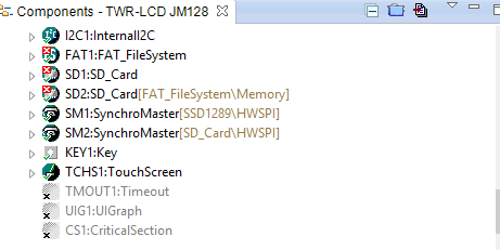

I am trying to use the TWR-LCD with or without TWRK60F120M.

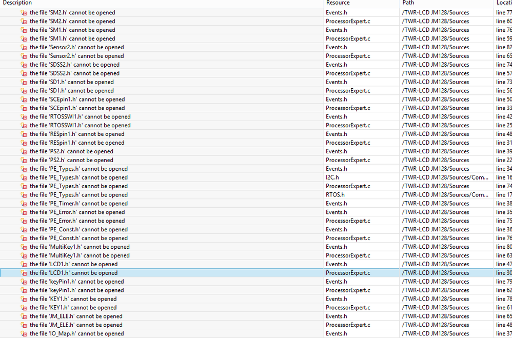

I tried these examples mcuoneclipse/Examples/TWR-LCD at master · ErichStyger/mcuoneclipse · GitHub  . I followed the guide and updated Processor Experts components (at first it didn't recognize the CPU), then I installed Coldfire for CW (I think some components needed it) and I still have errors.
I have several errors.
Can somebody try these project and confirm that they work? There is a guide in the JM128 Bootloader project folder, and I attached the PE Update file (from the TWR LCD CD).
Thank you!

Hello Tudor-Andrei Vrabie:
In your components view there are some missing components (the ones in gray). This implies you have not installed those and some files will not be generated.
Moreover the FAT and SD Card components have an error mark, then something must be configured incorrectly. Open the components properties and try to find the offending configurations.
Regards!
