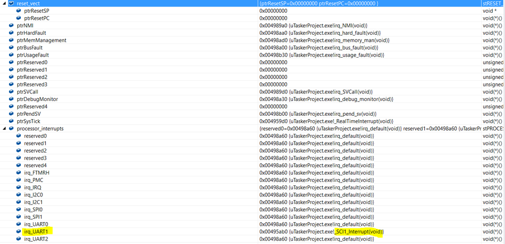

mjbcswitzerland
Specialist V
Here is a compact answer for a bare-metal solution.
1. Enter the interrupt (place interrupt handler address in SRAM, set interrupt priority, enable interrupt in NVIC) using
fnEnterInterrupt(26, 11, interrupt_spi0_data_received);
2. Enable SPI interrupt (in peripheral so that it is asserted to the NVIC input) as well as configuring SPI peripheral generally
3. Send SPI data and handle the interrupts generated in the process. Reading the received data will clear the interrupt in your case.
The hander routine should be declared as a standard subroutine [void function(void)]
Details about fnEnterInterrupt():
- assumes interrupt table is in RAM, set by VECTOR_TABLE_OFFSET_REG = RAM_START_ADDRESS, for example to set table to start of SRAM.
- the routine accepts the ID of the interrupt in question (26 is SPI0 for K60, for example, but can change between derivates), an interrupt priority (0..15, where 0 is highest), plus a prointer to the handler.
- the code is (translate to register names in your headers if needed)

} PROCESSOR_IRQ;
This is valid for K60 (for example) but the exact content is not actually important for just entering interrupts.

Hi Marcio
UART1 interrupt ID is 13 (on the KEA128) so I assume you need to find the (usually hard-coded in the KDSs) vector table and insert the interrupt handler there (where there is probably a default handler at the moment).
I assume that the UART driver will then support interrupts if you set some appropriate define(?)
Below is the view of the KEA128 vectors when I simulate it after inserting a UART1 handler called SCI1_Interrupt.
If you have continued problems see the following for a service to quickly help you solve it
http://www.utasker.com/services.html
