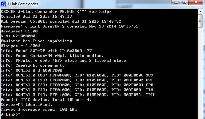

jeremyzhou
Hi Ceylia,
According to the message you shared, I think the root cause of issue is failed connection, Fig 1 shows the message about correct connection.
So please check the JTAG hardware circuit design at first, and I'd like to suggest that you can refer to the attachment for designing the JTAG interface.
                                                                          Fig 1

cwati
When i first connect the board to the debugger, it shows the following.  So I think there is some sort of connection happening.
SEGGER J-Link Commander V4.92 ('?' for help)
Compiled Sep 30 2014 09:33:51
DLL version V4.92, compiled Sep 30 2014 09:33:42
Firmware: J-Link OpenSDA 2 compiled Aug  4 2014 13:30:09
Hardware: V1.00
S/N: 621000000
VTarget = 3.300V
No devices found on JTAG chain. Trying to find device on SWD.
No device found on SWD.
Failed to identify target. Trying again with slow (4 kHz) speed.
Info: Found SWD-DP with ID 0x2BA01477
****** Error: Error while identifying Cortex-M core.
J-Link>
