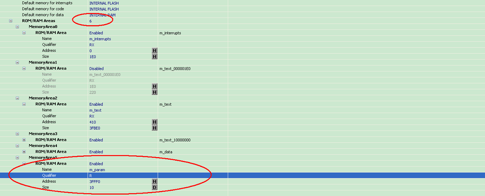

I want to store some default parameters in my Flash so that during boot-up time, my variables take those default values at start up.
How can I do this?
My controller is MK10DN512ZVLL10. And I am having a bare-metal project with the following build options:
Can you tell me what are these partitions like m_data and m_text for and how I can modify this, if I have to?
I want to specify a few parameters in Flash and let it stay forever. Then during start up, I would like to have a FLAG, if the flag is set, it means to take default parameters (will be our factory default parameters) for variables. If FLAG is clear it means start up the code normally.

Kan_Li
To do that, you have to modify the build option to generate a new lcf file, for example, a new 16bytes long section "m_param" is defined as below:
and in your code, use the following to predefine the data stored into that section:
#pragma define_section m_param ".m_param" abs32 RX
static __declspec(m_param) uint8_t m_param[0x10] = {
0x04U, 0x03U, 0x02U, 0x01U, 0x08U, 0x07U, 0x06U, 0x05U,
0x09U, 0x0AU, 0x0BU, 0x0CU, 0x0DU, 0x0FU, 0x10U, 0x00U
Please kindly refer to attachment for more details. !
Hope that helps,
B.R
Kan

PE has a flash API called FLASH_LDD.
However, I need to set aside a read only segment of my FLASH to store my factory default values (1KB is enough). It should be read-only so no-one must be able to write to it, intentionally or unintentionally. I think using Build options in PE CPU is a way to go, but I have had some problems so far in configuring it.
