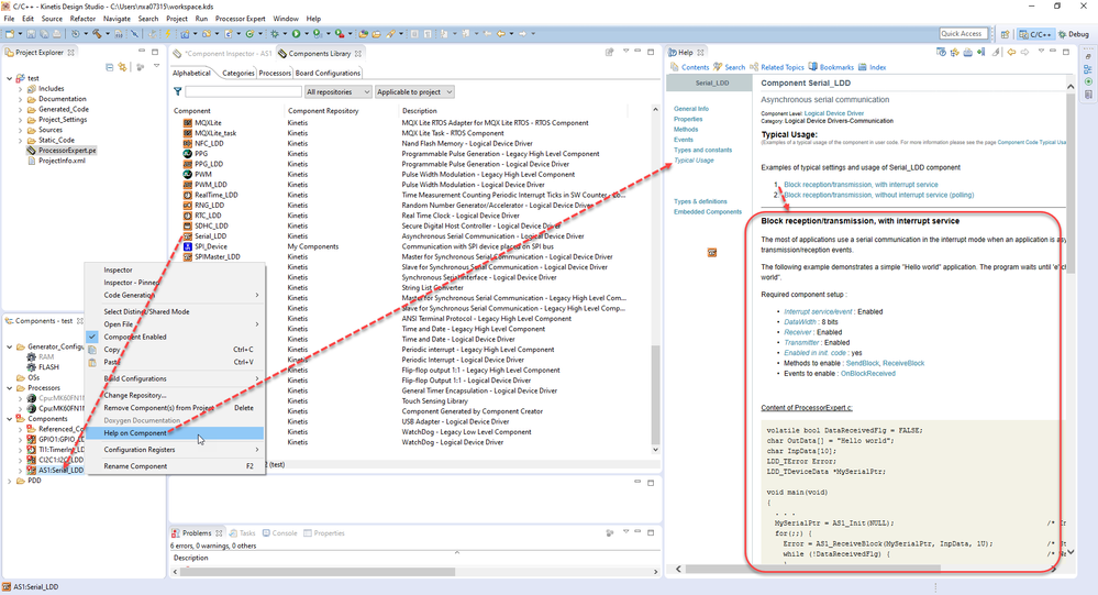

Hi YuZH,
MK60FN1M0VLQ12 is not in the support list of KSDK and MCUXpresso SDK.
So I am afraid you may need to develop it by using the Processor Expert in KDS3.2 or CW11.
If you have never used Processor Expert, then please refer:
Overview: Processor Expert
Getting Help on Processor Expert Components
There are several examples of typical settings and usage of xxx_LDD component. You can modify the setting in processor expert and copy the codes.
