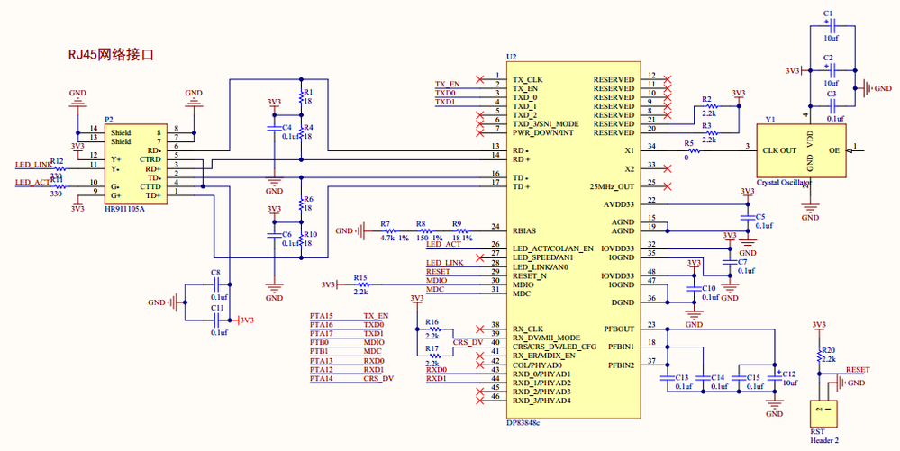

dingzhang
THANKS a lot for replying me.
  1. this is the way I'm linking the net line from PC to my K60 PCB board. This PCB board is not officially developed.
      U can see the big DP83848c Chip in the middle, it is a chip for changing bit stream into a RMII data, which can fit K60's RMII interface. Is this something u call as the network stack?
  2. Can I set K60's IP address in this PCB or situation?
  3. By the way, I'm using IAR as developing environment.
10,952 Views
dave408
Senior Contributor II
Hi Ding, first of all, I think you should unmark my answer as correct.  I haven't solved your problem, nor do I think I'm capable of offering a correct answer.  mjbcswitzerland or someone from FSL will be able to give you more detailed suggestions.
Some side comments:
  1. If your PCB is not one from FSL, you will probably have a hard time debugging anything unless you pick up a JTAG programmer
  2. IP addresses aren't set in hardware.  Using the network stack, which is software, you can set the IP address.  Since I don't know enough about ethernet programming, I have to use whatever FSL provides to me through the KSDK.  It looks like they support two PHY chips -- KSZ8041 and KSZ8081, so I use the KSZ8081.  Mark will be able to tell you for sure since his uTasker framework handles so many different peripherals.
  3. IAR has an ethernet demo available.  When I evaluated that IDE, I used it and it worked for my FRDM-K64F board.

tsi-chung_liew
To use the Ethernet module, you need to have a some background knowledge of Open software interconnection Model (short OSI model) which composes of 7 layers - Physical, Data Link, Network, transport, session, Presentation and Application Layer. The users above had mentioned about software stack or OS such as MQX had the OSI model implemented. The snapshot of schematic you provided is the Physical and data link combined, all they do is ensuring transmit and receive 1's and 0's. The IP addr, data etc are all embedded in the 1's and 0's, that's why you will need a software stack to encode and decode them. Information about IPv4 can be found here: IPv4 - Wikipedia, the free encyclopedia
Here is the link to obtain the Kinetis SDK: Software Development Kit for Kinetis MCUs|Freescale There is a Ethernet software example for TWR-K61 or TWR-K60 platform.
As for the snapshot of the schematic, you need to refer to our TWR MCU (K60D or K61) and TWR-SER2 for proper signals connection.
TsiChung

ndavies
Contributor V
DING, The network stack is software that is run on the K60. It contains all the software to communicate over Ethernet. You cannot just set an IP address and talk over Ethernet. It's way more complicated than that. You need a network protocol software stack to do it.
It is called a stack since it is designed in layers, each layer doing a specific function. This protocol stack can either be written by you, purchased or found online in open source software. There's a network stack included in MQX and the Kinetis SDK.
Norm
10,952 Views
ndavies
Contributor V
Zhang Ding, The Network stack provides the mechanisms to communicate with all the layers involved in TCP/IP over Ethernet including the MAC layers and the correct formation of the IP datagram. Your application will need to correctly call the functions in the network stack.
The network Stack requires functions normally provided by an operating system. The stack will need operating system support functions like allocating memory buffers, allocating Timers and registering interrupt functions. These don't need to be an actual OS. You just need to provide the functions to support this functionality.
MQX is an OS. Specifically a Real Time Operating System(RTOS). It provides both the network stack as well as the operating system support functionality. It is just one way to create your application. There are several free and commercial RTOS available. You could also write your own OS.
You will also need to use or create a protocol that is recognized by the device you are trying to talk to. Just setting an IP address and stuffing data into a datagram is not enough to get communications up between 2 devices.
Norm
