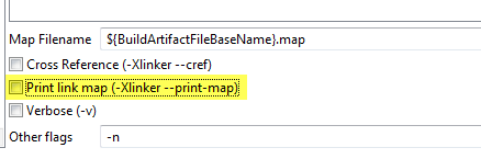

Say that, somewhere ,i erroneously declared an array with [1000] elements instead of[100] as needed,is it possible to put it in evidence in some ordered list?
I enabled the print options in the Project->Properties->Settings->Additional tools  but i'm only able to finde the total sizes in the console
Mytest.elf
   text   data    bss    dec    hex filename
  13604   3136   1596  18336   47a0 Mytest.elf
  13604   3136   1596  18336   47a0 (TOTALS)
Thanks for any help

that you are using your own linker file should not prevent the .map file generated.
But I see that you have the --print-map option enabled. With this, the map file is printed to the console view, and not as file. To have it as file, unselect this option:
Then everything should be fine.

Hello Diego:
Just as Erich suggested, you will find that info in the map file. Here an example:
In my code I have:
static uint8 my_buff[100];
Then in the map file I find the next:
The first number is the address in RAM, while the second is the size.
Hope this helps!

the matter is that i 'm not able to generate any map file
No result if i  search for it in the project folder.
How can i generate it?
Or should i look for other extensions?

This file should be in the FLASH folder, after you compile your project.
If it is not in there, go to Project -> Properties -> C/C++ Build -> Settings -> ARM Ltd Windows GCC C Linker; and check in the linker options whether or not there is a flag and a name to generate the map file:
And also in ARM Ltd Windows GCC C Linker -> Miscellaneous, check if you have a map file name:

These are my options
-T"C:\FRDM_KL25Z WorkSpace\DisplayOnlytest/Project_Settings/Linker_Files/ProcessorExpert.ld" -Xlinker --gc-sections -L"C:\Freescale\CW MCU v10.5\eclipse\../MCU/ARM_GCC_Support/ewl/lib/armv6-m" -Wl,-Map,DisplayOnlytest.map -Xlinker --print-map -n -specs=ewl_c.specs -Xlinker --undefined=__pformatter_ -Xlinker --defsym=__pformatter=__pformatter_ -Xlinker --undefined=__sformatter -Xlinker --defsym=__sformatter=__sformatter
In ARM Ltd Windows GCC C Linker ->Miscellaneous everything looks correct,but still the *.map file is not created
I edited my own linker file,so in PE the build option "Generate linker file" is not active.
Could this have to do with the lack of map file?

Thank you Erich and Jorge
yes ,unselecting the Print Link Map option everything works fine,i have the .map file now
Have a good week and thanks to everybody just for reading this discussion
