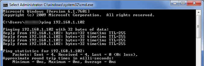

ivadorazinova
Hi Trilok.
the easiest way is execute command window (cmd) and type ping the ip address of the board.
For example: your IP address of the PC will be 192.168.1.100 and your device will be set on 192.168.1.102, be sure that ethernet cable is connected between the PC and the board, open the cmd and type ping 192.168.1.102.
You will see if the connection was susscesful.
In case of any issue, please let us know.
Have a nice rest of the weekend.
Iva
