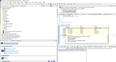

xiangjun_rong
As you know that the tools of KE17Z is MCUXPresso, IAR, keil, I have used the code to read UID.
uint32_t array[4];
int main(void)
/* Board pin init */
BOARD_InitBootPins();
BOARD_InitBootClocks();
array[0]=SIM->UIDML;
array[1]=SIM->UIDMH;
array[2]=SIM->UIDL;
array[3]=SIM->UIDH;
__asm("nop");
It is okay.
This is the register reading:
Hope it can help you
XiangJun Rong
