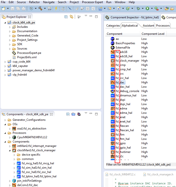

Which PE do you use ? the only PE or the KSDK-PE,  please scrennshot about your PE component,
I will know it.
If you use the Ksdk-PE,  like this
the PE diver is the KSDK driver.
Alice

Here is a screenshot of my environment:
I don't know if this helps?  Remember both, the team member and I, have equal environment and processor.... so what is it that I have to give to him once the
driver is complete on my side and he is asking for it (keep in mind I am using the above PE).

Hi Neil ,
What a pity, The diver are very different between  the PE and KSDK, in KDS , there is not the function to merge them.
I recommend you use one of them re-create the other project.
Alice

Hi Neil,
If you and the other team all use the PE, yes , the two project can merge.
While if you use PE, the other team use KSDK, it hard to merge.
"I recommend you use one of them re-create the other project."   I say this according to if you use PE,
the  other team use KSDK,  the better way is on your project develop the other code which the other team (use ksdk) made.
In a word use the same driver (PE Or ksdk) .
