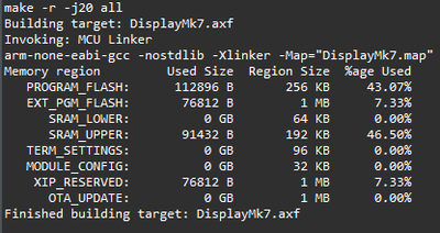

I was able to solve this.  It has to do with the memory aliasing that's used by the K8x.  My own comment is actually the solution staring me in the face!
/* 0x04020000-0x0405FFFF is XiP alias for 0x68020000-0x6805FFFF */
EXT_PGM_FLASH is the address region used by the K8x program counter.  XIP_RESERVED is the physical QSPI mapped address region.  The internal code always uses the EXT_PGM_FLASH, but when programming the chip the debug probe must use XIP_RESERVED.  So the region must be associated with the physical location by using the AT> option.
} > EXT_PGM_FLASH  AT> XIP_RESERVED

Note that EXT_PGM_FLASH and XIP_RESERVED are the same size. These are, respectively, the Alias and Physical address regions.

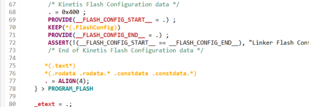

I see that you are working with Kinetis, all the Kinetis MCUs have at structure located at 0x400 thanks to linker.
// Flash Configuration block : 16-byte flash configuration field that stores
// default protection settings (loaded on reset) and security information that
// allows the MCU to restrict access to the Flash Memory module.
// Placed at address 0x400 by the linker script.
__attribute__ ((used,section(".FlashConfig"))) const struct {
    unsigned int word1;
    unsigned int word2;
    unsigned int word3;
    unsigned int word4;
} Flash_Config = {0xFFFFFFFF, 0xFFFFFFFF, 0xFFFFFFFF, 0xFFFF3DFE};

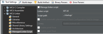

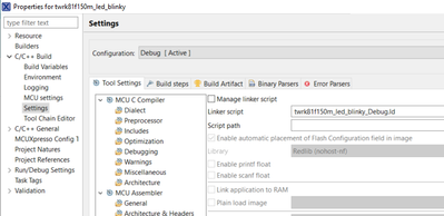

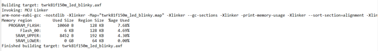

I proceed to create a secondary flash space. In  the MCUXpresso it looks like this on the MCU settings.
Then, I disabled managed linker script option
And I modified the linker to place my array at any desired offset on my secondary flash space.
Then the output was the following.
All the best,
