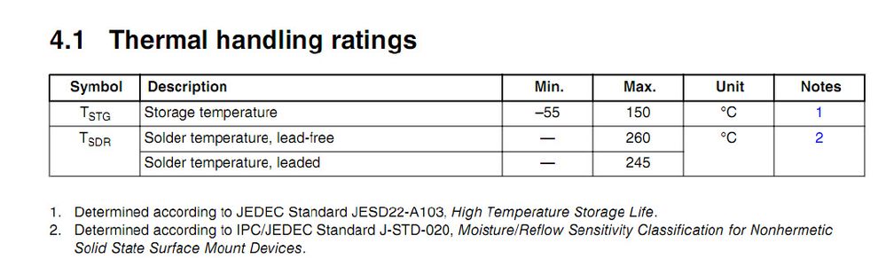

    If you solder the chip on the board by your hand, and you didn't care about the solder temperature, I think your chip maybe damaged to a large degree.
   A lot of people may damage the chip when they solder the chip and never care about the temperature.
   When you solder the chip by hand, take care of 2 points:
1. solder temperature below 260°C
2. solder time should as short as possible, long chip solder time may also damage the chip.
If you can't mass erase the chip and can't find the core, I suggest to solder an new chip and try again.

1. solid problem
   The solid temperature should not higher than 260°C, you can find this from the kinetis datasheet.
    the solid time should as short as possible, both the higher temperature and the long solid time may damage the chip.

>1. solider problem
I use the board in my office. (Maybe 10°C-20°C)
Take care, not the working temperature, it is the solider temperature, the chip solider to the board temperature!
A lot of people damaged the chip by the higher solider temperature.
What's your chip solider temperature?

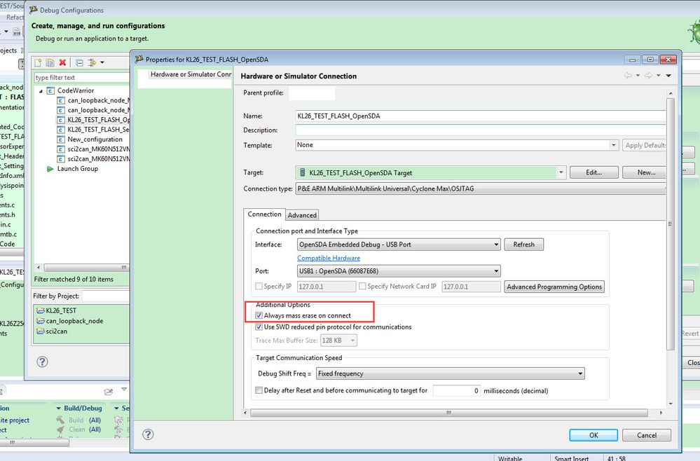

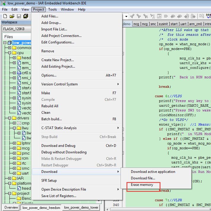

>Multilink Universal mass erase
Which IDE you are using? Some IDE have the mass erase button for Multilink universal tool.
Eg, CW and KDS:
IAR:
You can try it!
I use Kinetis Design Studio(KDS.
I tried mass erase by KDS, but I coudln't connect to the MCU.
I also tried mass erase by PROGACOMP(P&E's software), but I coudln't connect to the MCU too.
