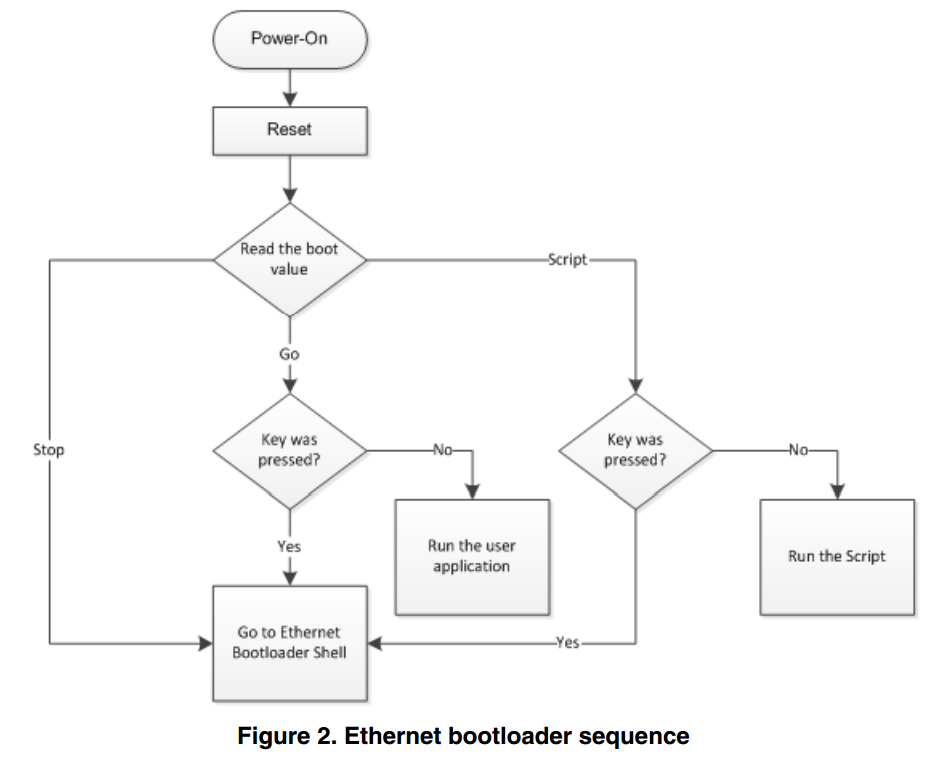

I'm doing a program that does the following: The principle is recorded a program that needs to be updated in the future , but this update will be made via ethernet using bootloader . I use the MCU frdm k64f . And I need help with this, because I do not know if it's really possible to do.

Hui_Ma
There is an application note about Kinetis Ethernet Bootloader.
Below is related software source code.
Wish it helps.
Ma Hui
