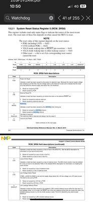

I need to know the restart reason of microcontroller on every reboot.
Example: Microcontroller can restart due to Watchdog, power cycle etc.
Can you please suggest me way to do that?

I've not used this part, does it have a Reset Control Module (RCM)?
Look for something like System Reset Status Register 0 (RCM_SRS0 and SRS1) etc.
Some times there are also 'sticky' copies. Better to use those results if available.

 Yes RCM->SRS0, RCM->SRS1 are the registers. this is complete detail. bobpaddock was right. you can read printf ("\r\n Restart reason code %.02x %.02x", RCM->SRS0, RCM->SRS1);
