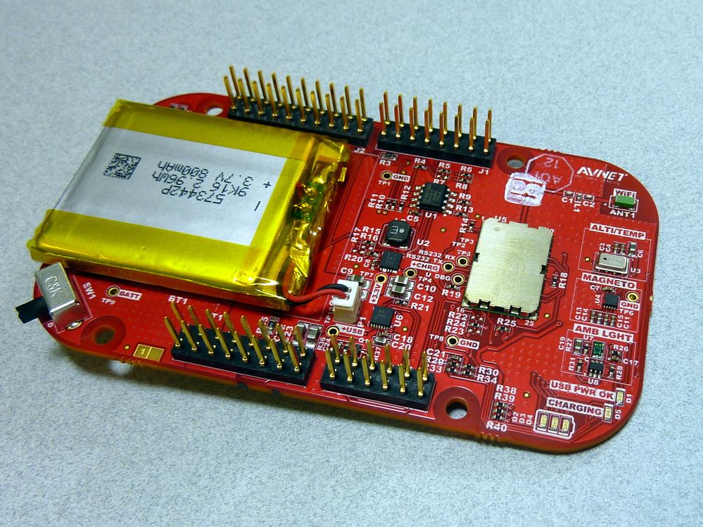

How to interface, wither a Ethernet or a Wireless Module to FRDM-KL25Z Board, and can you please tell me which modules will be good and cheep to buy as its my hobby project.

Avnet's "Wi-Go" expansion board for Freescale's FRDM-KL25Z Kinetis-L Freedom board provides 802.11bg Wi-Fi plus multiple sensors, SPI flash memory and 800mAh Li-Poly battery for extended use portable operation.
More details available here:
http://www.em.avnet.com/Wi-Go

gurindersinghgi
Hey Thanks For a Quick Reply But i was wondering as FRDM KL25Z Board runs Arduino Compatable Shields, so how does that work ,  like do we have some libraries or what ?
and i visited Arduino Shield List and there were Ethernet as well as ZigBee Shields Available so how to go about with that do you know ant tutorial regarding interfacing Shields .. :smileyhappy:

JimDon
Senior Contributor III
Yes, but just so there is no misunderstanding there still is no support for "Wi-Go" or any other network solution in a shield form. Avnet should create a PE "bean" for it. The big lesson from Arduino (and Raspberry Pi)  that everyone seems to miss is that it's all about the software support.
As it stands, this board is really not for hobbyists software wise.
