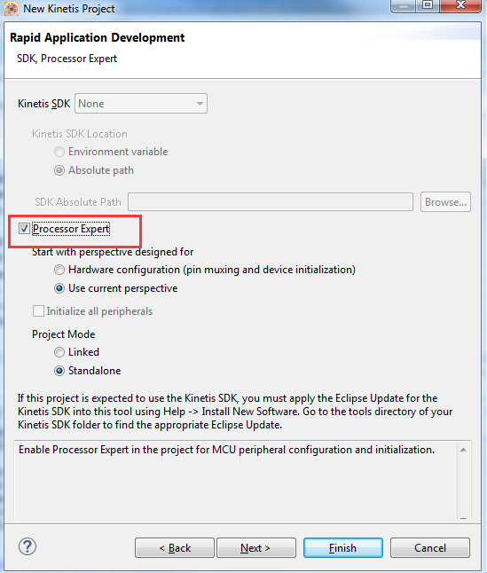

It seems you just want use KDS to develop K70,  so I recommend you can create Processor Expert project
on KDS, there is also example , they can directly run on KDS :
- When create project  ,please choose "Processor Expert" :

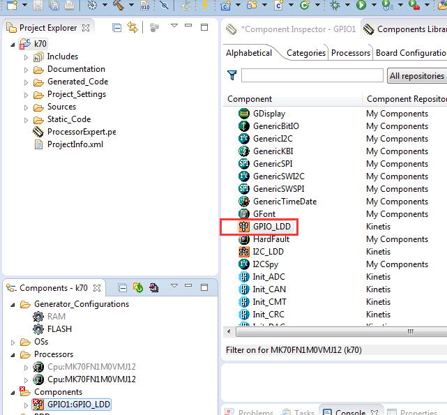

- For example , you want configuration a GPIO,  just double click "GPIO_LDD" , it will add to your project :

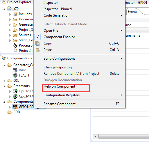

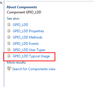

- Then click "help on component " -> Typical Usage :
Hope it helps
