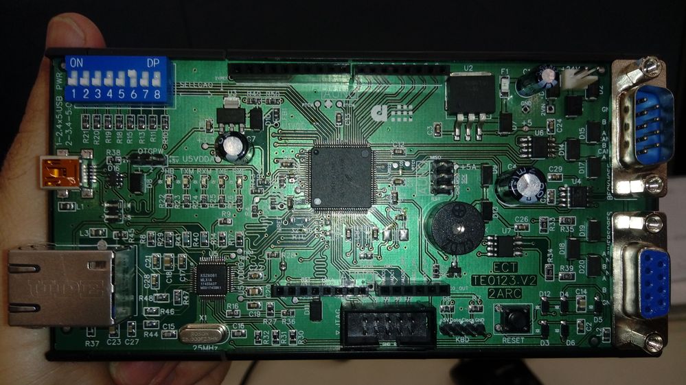

I am a hardware/software designer here in Brazil working for the Post (ECT). We are developing a protocol translator (Siemens/USS over RS485) using MK64FN1M0VLL12 (I got some free samples from NXP. Thank you very much). The UART part has been accomplished, but there is this demand to send some data to a USB host. In my hand-made board everything works like a charm through debug console (I put a 16 MHz crystal to pins 50-51 LQFP 100 pins package) but I got a “unknown device” in Windows when I try IRC48 MHz configuration.

We are in the proceedings of manufacturing some boards for testing in site. It works fine for the job it is required. And I know I can put an FTDI converting or so on the USB/UART side, but it will be nice to use on-chip USB feature that I brag about to my boss. Of course I can put a 16 MHz crystal into the board too, but a company has already been contracted to build it and I have not time to redesign the PCB.

Boards arrived. As I suspect I have a bogus MCU on my prototype kit. USB now is working like a charm (IRC48 or external clock).

I`ve uploaded the bin file into my board but it didn´t work (the USB, I mean). As I mentioned above this is a hand-made PCB, so there must be a hardware fault after all.
I took the liberty to attach a link to the schematic for further help:
https://easyeda.com/editor#id=2b73a1a614f04f84b376c955610659c1
See, in the datasheet VREGIN goes up to 5.5V and works as an input but VOUT33 works as an output. So they are in different circuitry inside the MCU, right?
Although in page 75 of the same datasheet one can read “Connect VREGIN and VOUT33 together and tie to ground through a 10 kΩ resistor. Do not tie directly to ground, as this causes a latch-up risk.”
This is a bit of confusing. I my case it works only when I tie them to 3.3 VCC directly, as you can see in the page 1 of my schematic. I tested the 10 K Ohm resistor too with no avail. Well, in that page it is written “Unused analog interfaces” but USB is not analog, right?
Am I doing it right? I am not an expert in this issue, so in the final board I´ve put 0402 pads arranged in a way that I can choose what to do with soldering iron, for I am hoping that in a machine-made PCB with all neat tracks, length tuning etc. it will work.

I don't know whether you loaded a binary file that is suitable for your board - it may expect the 50MHz oscillator on the FRDM-K64F board and so not be starting correctly.
Therefore I have built a version that runs entirely from the IRC48MHz (as main clock and for USB device) - I also blink your HB LED at 2.5Hz so that it can be seen that it is running.
The USB should appear as USB-CDC.
It is however very likely that you have a HW problem because the USB PHS is an analogue circuit and needs to be powered. VREGIN and VOUT33 are only tied together when not used - it is best to use the standard circuit which is to connect VREGIN to the USB 5V (so that it is only powered when USB is connected) and add a 2.2uF capacitor (low ESD) to VOUT33 (without this the circuit is not stable and USB may not operate).

Now with this new one, I´ve followed the FRDM-K64F reference design on page two. I´ve put VREGIN to USB 5V, put the cap, uploaded the bin file, but the HB LED goes always on, forever, and nothing happens on Windows Device Manager, not even an error message appears.
As I´ve told you in the previous message, I don´t know why, but in my prototype board USB only works when I tie VREGIN to VOUT33 to 3.3V directly. May it be a MCU fault then? I don´t have another one hanging around.
In the final board there will not be a 16 MHz crystal, for I was expecting it to work, perhaps I was not clear, my fault.
About two weeks ago I received authorization to produce the board, so I removed the 16 MHz on my prototype board and then begin to test it without external crystal (Yes I know, just now?) and only with IRC48M, and for my surprise, it doesn´t work.
