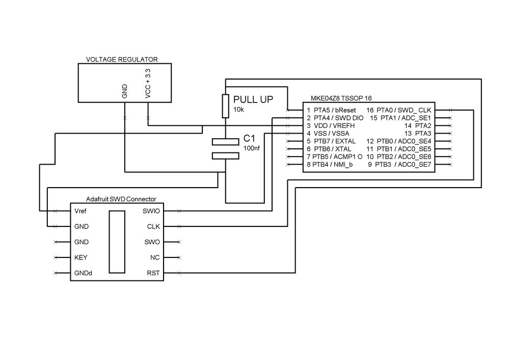

i make a new order of KE04Z and try it again :smileyhappy: the TSSOP - Package is nice to plant to pcb :smileyhappy:. I damaged the first order :smileyhappy: i think i was wrong with pin counting :smileyhappy: .
I make a circuit can you take a look.
About J-Link i dont need OpenSDA ? Like FRDM Boards ?
I think in my buy list is a FRDM board not wrong, Kwikstik is complicate to use pin (pci express 164 slot )

you can use the Kwikstick as programmer/debug tool (see Using the KwikStik K40 Board to Debug an external Board | MCU on Eclipse ), but if your project is hobby/non-commercial I recommend you get a J-Link EDU Mini (J-Link EDU Mini | SEGGER - The Embedded Experts ) which should be available from your distributor (Farnell or Mouser for example).
That way you don't have to use any OpenSDA.
Erich

Thank you Erich! Is my circuit okay ?
