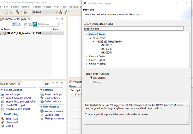

Also when i create a new bare board project, i don't see a choice for KEA128 under devices.pastedImage_0.png

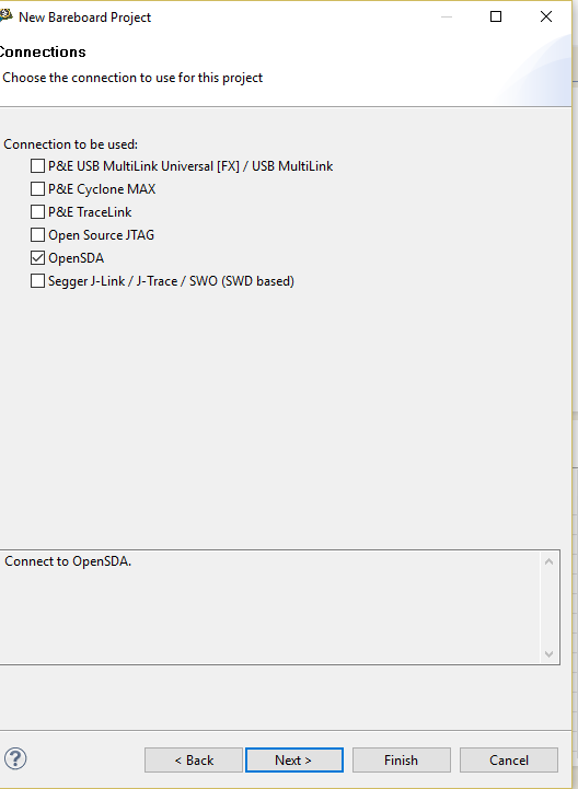

but going through the following
and connector type is nor undefined as follows
sorry for so many questions i am just new at this

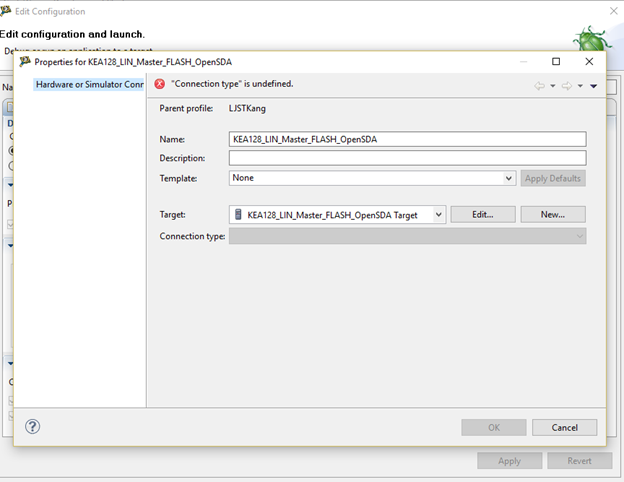

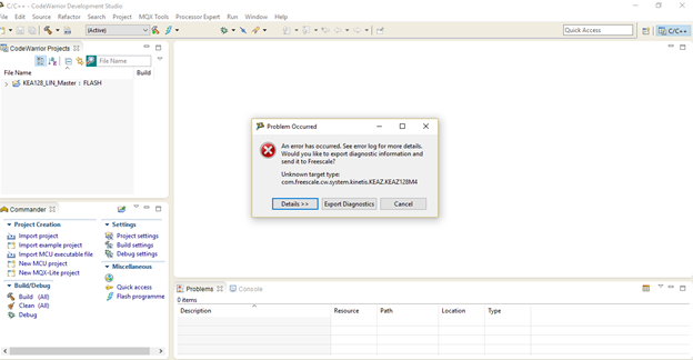

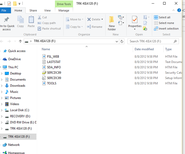

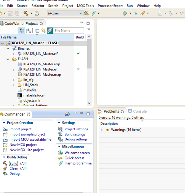

Hi just got the TRK-KEA 128 dev board. Opened processor expert kinetis project
still I was able to build this project and create an elf
in my debug settings my connection type is undefined
I also did the following as per the sda document. dragged the . SDA

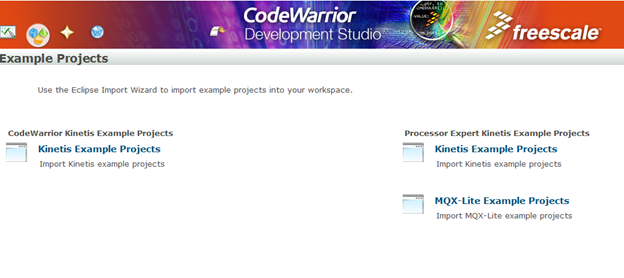

david_diaz
Hello Alan,
In this case, I recommend the TRK-KEA Quick Start Guide, in order to get familiar with the device.
You will find an introduction and default settings about TRK-KEA in the following link:
http://www.freescale.com/files/soft_dev_tools/doc/user_guide/KINTESMCUAUTQSG.pdf
As is showed in the document mentioned, the device counts with OpenSDA USB Port in order to program the board.
Please find more information about the OpenSDA USB Port and CodeWarrior Quick Start Guide in the following links:
  1. OpenSDA USB Port
http://www.freescale.com/files/32bit/doc/user_guide/OPENSDAUG.pdf
  1. CodeWarrior Quick Start Guide
http://www.freescale.com/files/soft_dev_tools/doc/quick_ref_guide/MCU_QS.pdf
Besides that, I recommend the Kinetis Peripheral Module Quick Reference in order to know more about the labs examples provided.
This collection of code examples, useful tips, and quick reference material has been created to help you speed the development of your applications.
Please find the document mentioned in the following link:
http://www.freescale.com/files/32bit/doc/quick_ref_guide/KQRUG.pdf
Hope this information will be useful for you.
David Diaz.

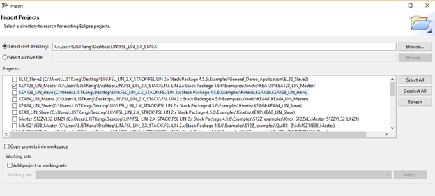

carloshass
David,
I downloaded the latest examples from http://cache.freescale.com/files/microcontrollers/software/device_drivers/FSL_LIN_2.X_DRIVER.zip?fas... .
I can use Kinetis Design Studio or only Code Warrior ?
Because inside zip, on folder Examples\Kinetis, is not a kinetis project?
3,667 Views
david_diaz
Hello Carlos,
The examples contained on the following path, are supported by CodeWarrior.
FSL LIN 2.x Stack Package 4.5.4\Examples\Kinetis\KEA128
David

saya
I found out that I didn't patch the KEA-CW package yesterday and thus my device is not shown when flashing.
