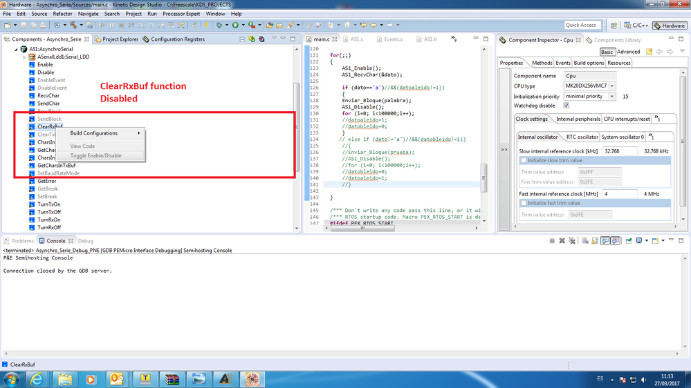

I´m developing a serial application. In my application my MK20DX256VLH7 microcontroller is waiting for a date that is sent from the PC by serial line. I've just managed to receive a date from PC to microcontroller, but the problem is that I want to clear the buffer once the microcontroller has read the data that has been received. The ClearRXBuf funtion that I hope to do this functionality, it's disabled, and I don't know how to enable this function, because when I click right in this method in "Components View" to select "Toggle Enable/Disable" this option is desabled.
I show you in the next image what I want to mean.

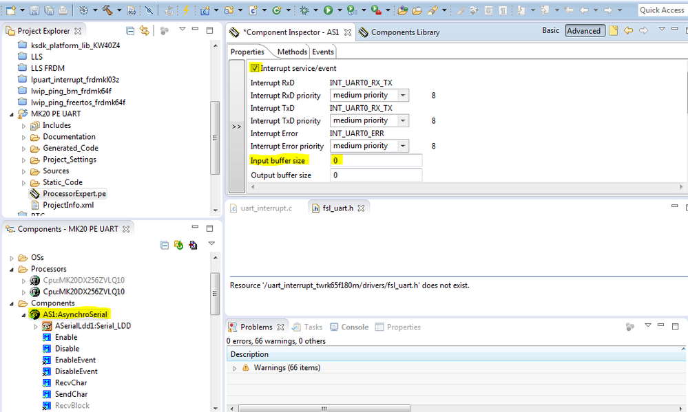

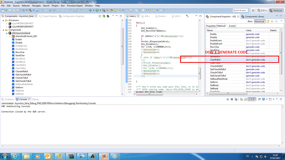

On the other hand in Methods tab from Component Inspector View, I'm disabled to generate code for this function. I show you in the next image.
Does anyone know how to enable this function?
Do I have to configurate some settings in Component Inspector View to generate this function?? Do I have to add a new plugging??

To enable this function there are two conditions.
1.- Receiver property enable.
2.- Input buffer size != 0.
To change the input buffer size:
Click on AS1:AsynchroSerial ->Interrupt service/event -> change the input buffer size.

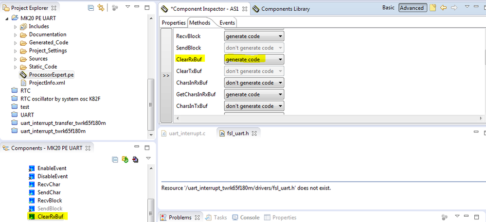

This enables the ClearRxBuf:
