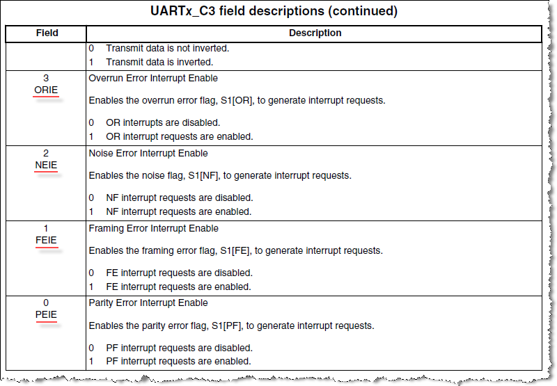

Please check the value of UARTx_C3 to ensure these Error Interrupt are disabled.

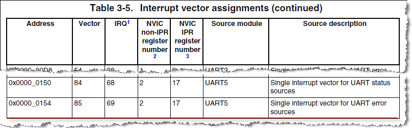

Here is the Interrupt vector assignments, you can also check if the UART error sources is disabled in NVIC.
