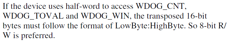

If you do start using the watchdog beware of a further possible confusion due to a documentation error:
https://community.nxp.com/message/417610
Also try to avoid blocking code since it is both inefficient and, when retriggering the watchdog, could block for an unwanted reason yet not cause a watchdog timeout (unsafe).
Mark

While that might apply to the KE02 (I can't check that now), it does not seem to apply to the KE04 I am testing today.
I use 16 bit accesses to read and write the WDOG_CNT, WDOG_TOVAL and WDOG_WIN registers.  My register access method is this:
#include <stdint.h>
// macros for direct register accesses
#define REG(address) (*((volatile uint32_t *) (address))) // generic 32 bit-aligned access
#define REG16(address) (*((volatile uint16_t *) (address))) // special 16 bit-aligned access
#define REG8(address) (*((volatile uint8_t *) (address))) // special 8 bit-aligned access
I use the REG16() macro to define the addresses of the 16 bit WDOG registers:
// WDOG
#define WDOG_CS1 REG8(0x40052000) // control and status register 1
#define WDOG_UPDATE (1<<5) // 1=allow updates
#define WDOG_EN (1<<7) // watchdog enable 0=disable 1=enabled
#define WDOG_CS2 REG8(0x40052001) // control and status register 2
#define WDOG_CNTH REG8(0x40052002) // counter register high
#define WDOG_CNTL REG8(0x40052003) // counter register low
#define WDOG_CNT REG16(0x40052002) // 16 bit watchdog timer counter
#define WDOG_TOVALH REG8(0x40052004) // time out value high
#define WDOG_TOVALL REG8(0x40052005) // time out value low
#define WDOG_TOVAL REG16(0x40052004) // 16 bit timeout value
#define WDOG_WINH REG8(0x40052006) // window value low
#define WDOG_WINL REG8(0x40052007) // window value high
#define WDOG_WIN REG16(0x40052006) // 16 bit window start value
If the warning expressed in the linked "Confusion..." post were true, my WDOG refreshes would not work, but they do:
void reset_wdog(void) {
 // reset watchdog timer to prevent reset
 WDOG_CNT = 0x02A6; // reset sequence 1/2
 WDOG_CNT = 0x80B4; // reset sequence 2/2
I don't swap the high and low bytes, and I don't use 8 bit accesses.  It still seems to work.  Also, I can write 0xFFFE to the WDOG_TOVAL register and it reads back correctly - not swapped.
I did find that this 16 bit access method did not work for setting the baud rate divisor register for the UART, and went back to double 8-bit accesses.
I have tried this in both IAR 7.8.3.12146 and Atollic TrueSTUDIO Lite 7.0.1 with the same results.
I agree with you on the point you make about blocking code.  This is being used in very simple proof-of-concept code and should not see production release.
I still don't understand why the WDOG_CS2 and WDOG_TOVAL registers have to be written as part of the WDOG disable procedure.  I don't _have_ to know.  I'd just _like_ to know.  Any thoughts?

This applies to all KE and KEA devices.
- The reset sequence that you use works because the bytes in its value are already swapped (the value in the data sheet is correct for 16 bit accesses)
- Writing and reading will always result in the written value being returned (it is not a test of whether the storage is little or big endian)
From the KE04 manual:
I have no idea why the writer prefers 8 bit read/writes (possibly they can't work out how to swap bytes???)
However the manuals still have the reported error: since the manual's own note is not respected....
If you want to check, write WDOG_TOVAL = 1000, which you would think gives a 1s watchdog time out. It will give about 1 minute. Then change to WDOG_TOVAL = (unsigned short)((1000 >> 8) | (1000 << 8)); and you will see that it then correctly gives 1s.
I have tested on KE02 [20 and 40MHz parts], KE04, KE06, KEA08, KEA32, KEA64, KEA128 (using KDS, CW, S32, IAR, uVision, Atollic, Rowley Crossworks, CooCox, Green Hills and GCC makefile) and found the same in each case.
I can't explain why the WDOG_S2 write is needed. I wrote the code a few years ago and apart from the note about it being "needed" I don't remember the details. Probably it was found through trial and error (like working out the example's timeout error) since there is nothing specific in the manual.
Mark

The KE/KEA series look to be intended to wean 8-bit users onto 32 bit processors. Much of the documentation is written as if the chip were 8 bit (some peripherals have indeed been taken from previous big-endian 8-bit chips) and also the GPIO ports are named as if they were 8 bit, even though they are in fact full 32 bit impementations.
In most cases this doesn't really matter but in some it complicates and confuses:
- for example the watchdog text gives values for 16 bit writes that respect the fact that the underlying HW is big-endian. No problem as long as all writes are 16 bits (and there is no reason why they shouldn't be) but the same confusion would occur if someone decided to write these values as two bytes writes since they would probably do it wrong the first time (and maybe lose a day or two of work in the process)
- the port naming convention is "Horrible" since it makes code compatibility between K (or KL, KV, KM, KW) parts and KE/KEA quite a challenge whereby if 32 bit naming had been used it would have been simple because the underlying HW is almost identical...
