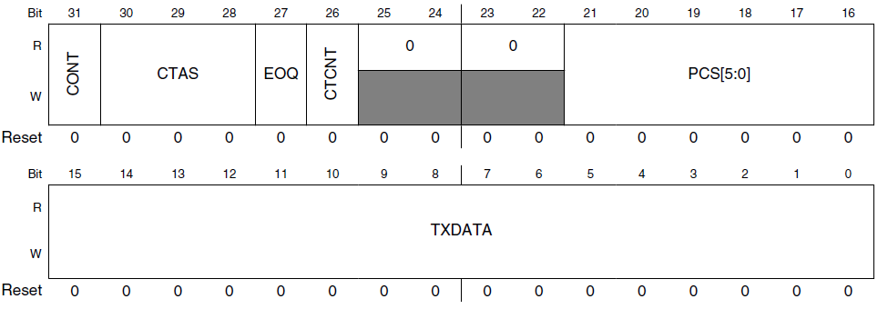

When you transfer data you need to write to the PUSHR which looks like this:
It has 2 bytes of command and 2 bytes of data; every time you transfer you need to write completely to this register and when you write your last data you need to set the EOQ bit.
You can check for this bit in the SPIx_SR register and also check for the TFFF flag which indicates that the TX fifo is full. You can implement this with this code:
    while(!(SPI0_SR & SPI_SR_TFFF_MASK)) {} //wait till TX fifo not full
    while(!(SPI0_SR & SPI_SR_EOQF_MASK)) {} //wait till the las entry has been transmitted
    SPI0_SR  |= SPI_SR_EOQF_MASK; //clear EOQF flag
    SPI0_SR     |= SPI_SR_TFFF_MASK; //clear TFFF flag

I don't believe the approach you suggested would indicate that the CS bit has been negated.  It would effectively wait for the transmission to complete which is earlier i.e. when the last bit has been clocked out..  However I will spend some time checking this.
