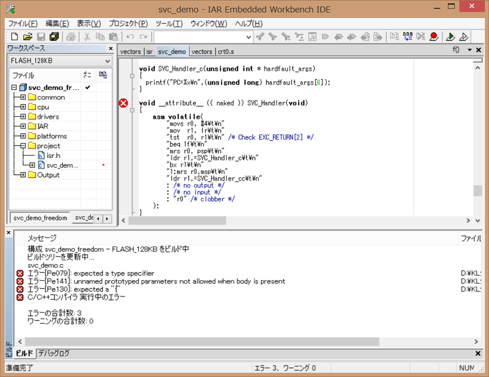

I would like to know how to describe a naked attribute function.
The code was compiled successfully with a standalone GCC but IAR GCC could not and display the following error messages.
エラー[Pe079]: expected a type specifier D:\KL25 Sample Code\kl25_sc_rev10\klxx-sc-baremetal\src\projects\svc_demo\svc_demo.c 238
エラー[Pe141]: unnamed prototyped parameters not allowed when body is present D:\KL25 Sample Code\kl25_sc_rev10\klxx-sc-baremetal\src\projects\svc_demo\svc_demo.c 238
エラー[Pe130]: expected a "{" D:\KL25 Sample Code\kl25_sc_rev10\klxx-sc-baremetal\src\projects\svc_demo\svc_demo.c 238

These type of things are not standard and so are compiler specific.
You can use a define instead and declare the define according to the compiler used and then it is automated.

Try the non-standard extended keyword __stackless
Mark

Hi Mark,
thank you, the compilation was done successfully with __stackless.
However, the __stackless keyword was not accepted by the standalone GCC.
Is it IAR specific keyword?

Hi Mark,
thank you for good advice. I agree with you.
