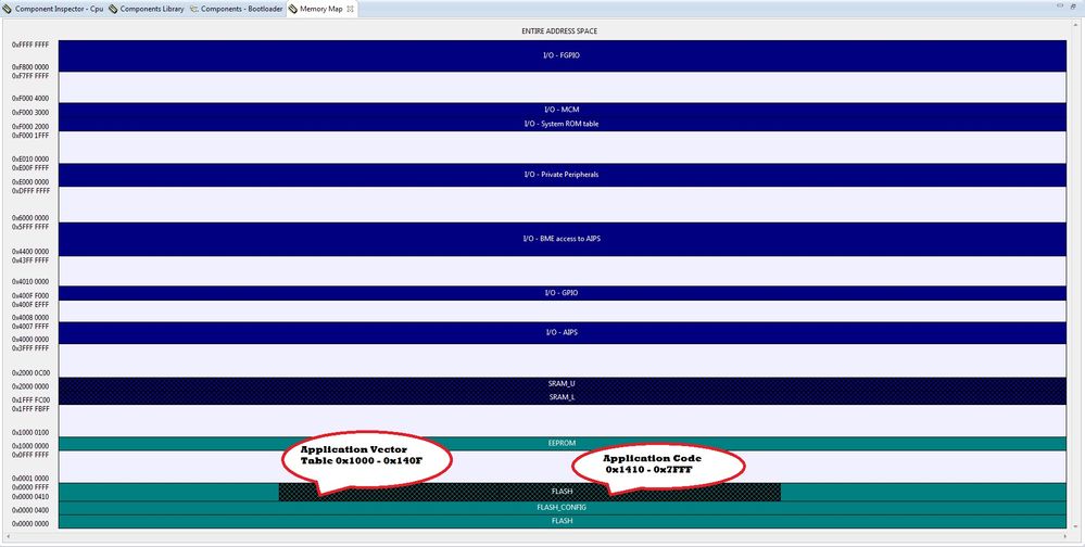

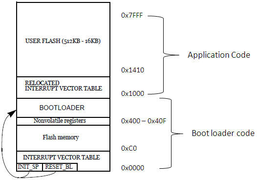

I am designing a boot loader for MKE02z64VLD2 microcontroller in Kinetis Design Studio. I have configured the Flash Memory area as per the AN 4775 documentation (IIC Boot Loader Design on the Kinetis E series). In this document, in page number 9, I found this.
So I implemented the same for my boot loader.
This is how my memory map looks like.

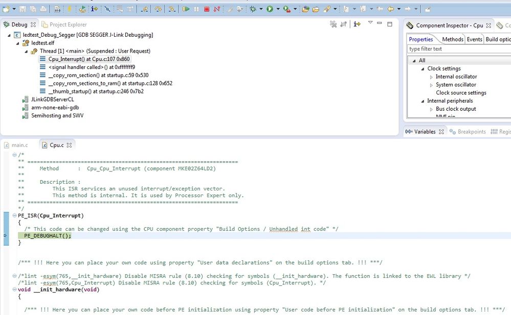

But when I flashed this into my board using J link debugger, This message popped up. Semihosting process monitor job failed, Java.lang.IllegalThreadStateException .
After this failed flash job, I tried to debug a simple LED blink code, but it didn't get executed. It threw me these errors.

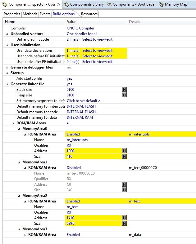

Hello Ganesh,
I think maybe you have some mi@sunderstand about the bootloader code and the Application .
On the bootloder project, you needn't change the linker file and vector table , you need change the
linker file of APP project . For example , if the APP run from 0x1000, you need configure the linker file
m_interrupts area from 0x1000.
An important place is the jump code , when want to jump to the APP, please use the SCB_VTOR
point to the 0x1000.
There is a bootloader demo about KE02z64vll4, you can refer to the jump code :

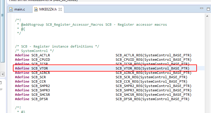

In your code you have used 'SCB->VTOR', whereas I have used 'startup' . Should I change the word 'startup'  to 'SCB->VTOR' in all instances of my code ??

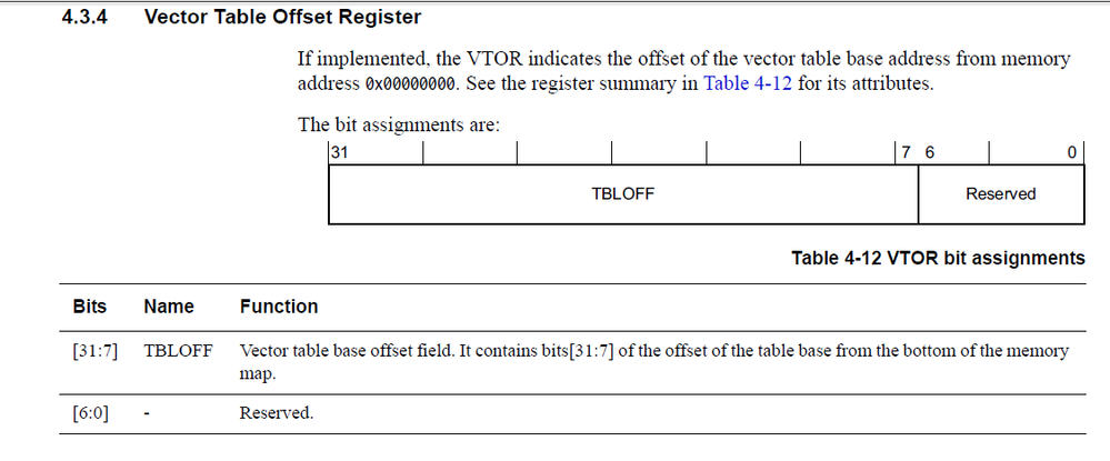

Hello Ganesh,
On my code , the SCB_VTOR is not one simple variable, it is a register Vector Table Offest Register,
you can find on the cortex-m0+ Devices Generic User Guide:
Hope it helps
