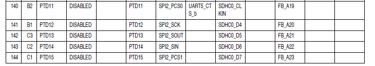

Correct -- the SPI module will do ALL CS setup/toggle/hold for you if muxed-in to do so, as you have.  GPIO will be disconnected.
The 'Rev 2' examples may NOT be your 'best' choice, as you are working with Rev 1 silicon (Z at the end of the part number).  By the same token, you probably shouldn't be using the 'V2RM' document you list---the Reference Manual for V2 silicon.  Your P/N isn't listed on the first page of THAT manual because you need K60P144M100SF2RM, plus the additional note that your chip starts with 'P' (Prototype) meaning 'very early silicon', and is subject to a 'number' of errata, based on the mask code you will find on it.
Be all that as it may, as far as I know pins PortD11-14 ARE muxed with SPI2 for either version of chip. and so the SPI2 example you have should work.
It is confusing, but note that while these 'Tower Elevator' SPI pin names all start with 'SPI0...', the TWR-K60 CPU module has them linked to SPI2, as in this bit of schematic:
