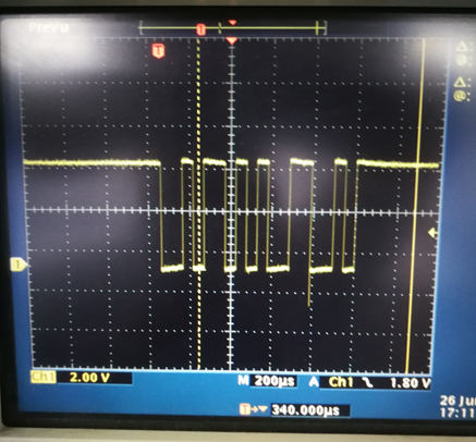

Although there is a baud rate definition TERMINAL_BAUD, but it is never used too. MCU bootloader2.0.0 use auto baud rate detection. When power on, bootloader will go to autobaud detection mode. KinetisFlashTool sends ‘0x ’ every second. Bootloader check this byte and calculate baud rate.
After getting this value, bootloader will change to normal communication mode. Baud rate will not change until reset. If blhost is used, subsequent blhost invocations must specify the same baud rate as was used for the initial invocation unless the bootloader is reset. If the baud rate is not specified using the -p COMx, <baudrate> option, the UART baud rate will be set to 57600.
